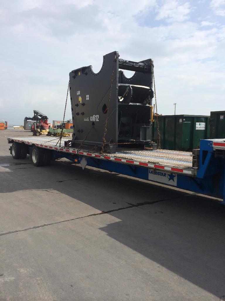

  8. I'll chime in.
    Depending on where your dunnage is located. Will depend on the distribution of the weight that rides on the two spead axles.
    You can have. 17,000lbs on front spread axle and 9,000lbs on rear spead axle.
    Loads don't evenly distributed between a spead axle.
    In this picture the front axle of the spread is carrying more weight than the rear axle.
    This box is distributed between both axles as well as weight from the white tank adding weight to the front axle.
    Just a couple examples.....
    Lepton1 and johndeere4020 Thank this.
