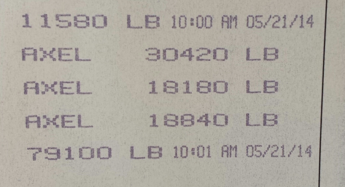

    Here is on level pads. Nothing raised. drove on weight on pad 1 and 2
    Then move to weigh 2 and three
    Lepton1 Thanks this.
