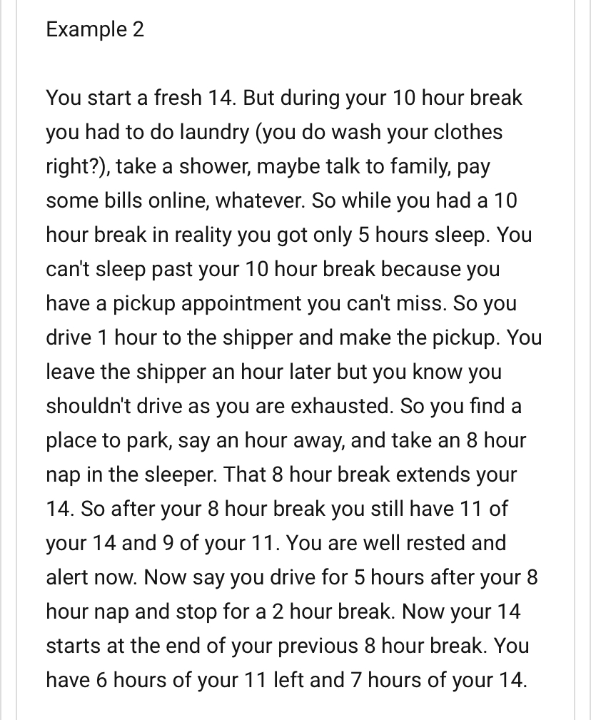

    I know this question has been answered a hundred times over, but I am having such a hard time grasping the 8/2 split!!
    So, I understand the basics.
    Another user posted two examples, (see attached photos).
    In example 1 they said after after 8 hours in the sleeper you get 6h drive and 9 on duty.
    So, I guess my question is how do you get out the the 8/2 split after you have entered it. My understanding is you can take 2h off duty and 8h in sleeper. But, you must take a 2h off duty and 8h in the sleeper, but you don’t get you full 14h on duty and 11h drive.

    When you are splitting sleeper add your work periods before & after your sleeper #1. Those work periods (driving or on-duty) must not exceed 14. Your driving periods, before & after your first sleeper or rest period, must not add to more than 11 hours.
    Using example 2, you go into 1st Sleeper period with 10:45 of your 14 available (15 min PTI + 2 hours driving). After 8 hours in sleeper you drive 5. That reduces you to 5:45/14 On-Dutyand 3/11 Driving remaining.
    Go in sleeper for 8 (more than needed to complete Split Break). 8 Sleeper + 8 Sleeper, more than 10 hours gives you a new 14 On-Duty and a new 11 Driving.
    That's how I see it. I avoided Split Break like a rattlesnake. It's easy for me to get confused and get what they call an Egregious HOS Violation, where messing up a rest period by 5 minutes gets you a violation of several hours of illegal driving, for example.

    Thanks so much for the info I have two follow up question.
    #1 I am also going to keep the numbers, and scenario simple. So, I have a full 11 and 14 hour clock, wake up and drive 10 hours go off duty for 2h drive 30min and go to sleeper for 8h, I wake up and have 10:30 min drive and 13h 30min on duty, did I get this right?
    #2 If I take my 2h off duty, and then take, lets say, a 13hin the sleeper, will that 13h in sleeper not reset all of my clock as if I did not do a split sleeper birth. Or, do I need to take a 10h after what ever hours between brakes are given back?
    And, again thank you so much for the info.

    Allow me to clarify number two, please. You start with a full 11h and 14 hour clock. You drive 5h, and take a 2h brake, drive 1h, and normally you would take an 8h in the sleeper to complete the 8/2 split. Now, thanks to your explanation, I now understand you would subtract that 1h from your next days time, and have 10h and 13hours available. But, let’s say, instead of taking an 8h you take 13h in the sleeper after your 2h brake and 1h drive. The following day, do you get a full 11h and 14h clock back? Or, do you still only get a 10h and 13h clock back, and only after that shift, and a continuous 10h brake do you get your 11h, and 14h back?
