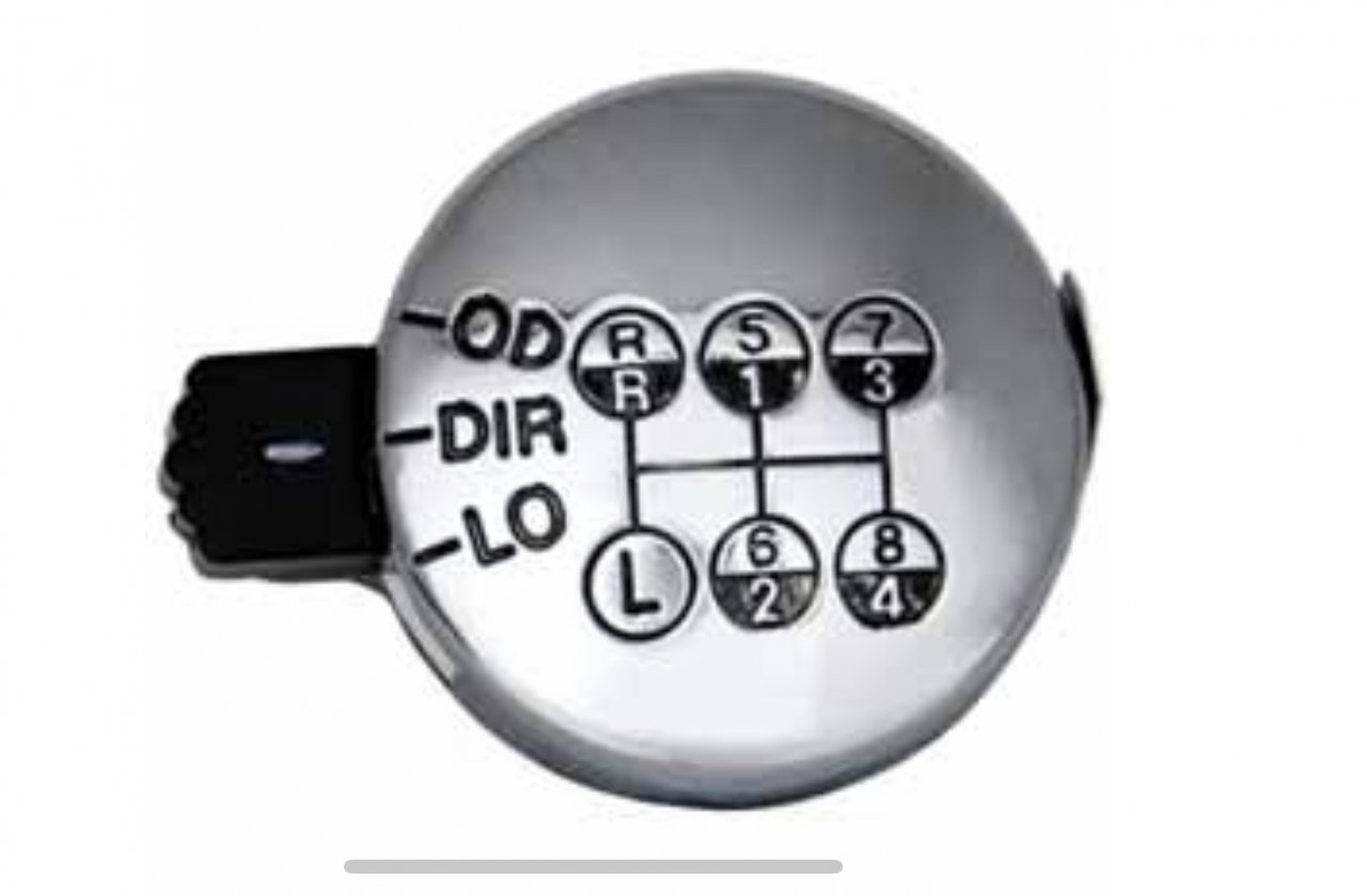

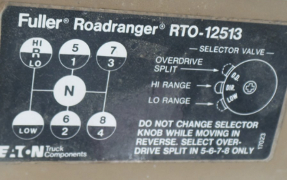

    Your question seems to mainly focus on ‘splitting’ gears, and how to split them.
    I’m not much with words, but I’ve shifted many gears in the last 36 years. See if this helps.
    Your question is on a 18 speed which gives the ability to split all gears. And the 13 only splits the upper gears in the high side of the transmission, so I’ll use the 13.
    After shifting the low range gears 1/2/3/4 you will obviously split to the high side.
    Once in the high side, you can begin splitting all the gears. At this point you will be in 5th gear with the thumb button in the high range ‘or’ direct position.
    Your next shift will be shift from 5 direct, to 5 overdrive simply by moving the thumb button to the OD position and letting up on the throttle to relieve he pressure on the gears, and allowing the transmission to go into OD.
    Your next shift will be from 5/OD to 6/DIRECT… ease up on the throttle till the shifter eases out of 5th and as it starts into 6th move the thumb button from OD to DIR. You just split 2 gears at once. many like myself never use the clutch, but you can.
    On the next shift simply move the thumb button from 6/DIR to 6/OD.
    Now your ready to split gears again… 6/OD to 7/DIR. Making sense??
    So this is what you’re doing…
    Shift 5/DIR to 5/OD
    Split 5/OD to 6/DIR
    Shift 6/DIR to 6/OD
    Split 6/OD to 7/DIR
    Shift 7/DIR to 7/OD
    Split 7/OD to 8/DIR
    Then shift in to the big cog… 8/DIR to 8/OD.
    On the 18 you just split all the gears in this fashion. Hope this makes some sense, I’m not much with words….
