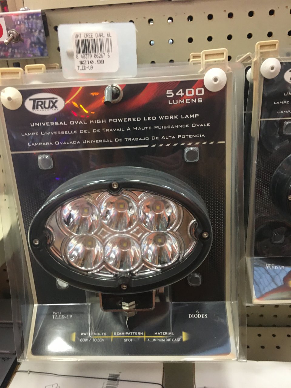

    Anyone run these as extra lights I’m not referring to work lights or back up lights but a spot lamp I’ve noticed a few trucks on I-80 during evening time they really give a great beam But mostly mounted on the bull bar or bumper have yet to see an American trucker with these types of lights mounted on the sun visor

    I have a couple of those 5400 lumen Trux in my bumper, they make nice fog lights and dark lot maneuvering lights. If you're using those lights while on the interstate or able to see any other vehicle lights it should be legal to throw hammers at you.
