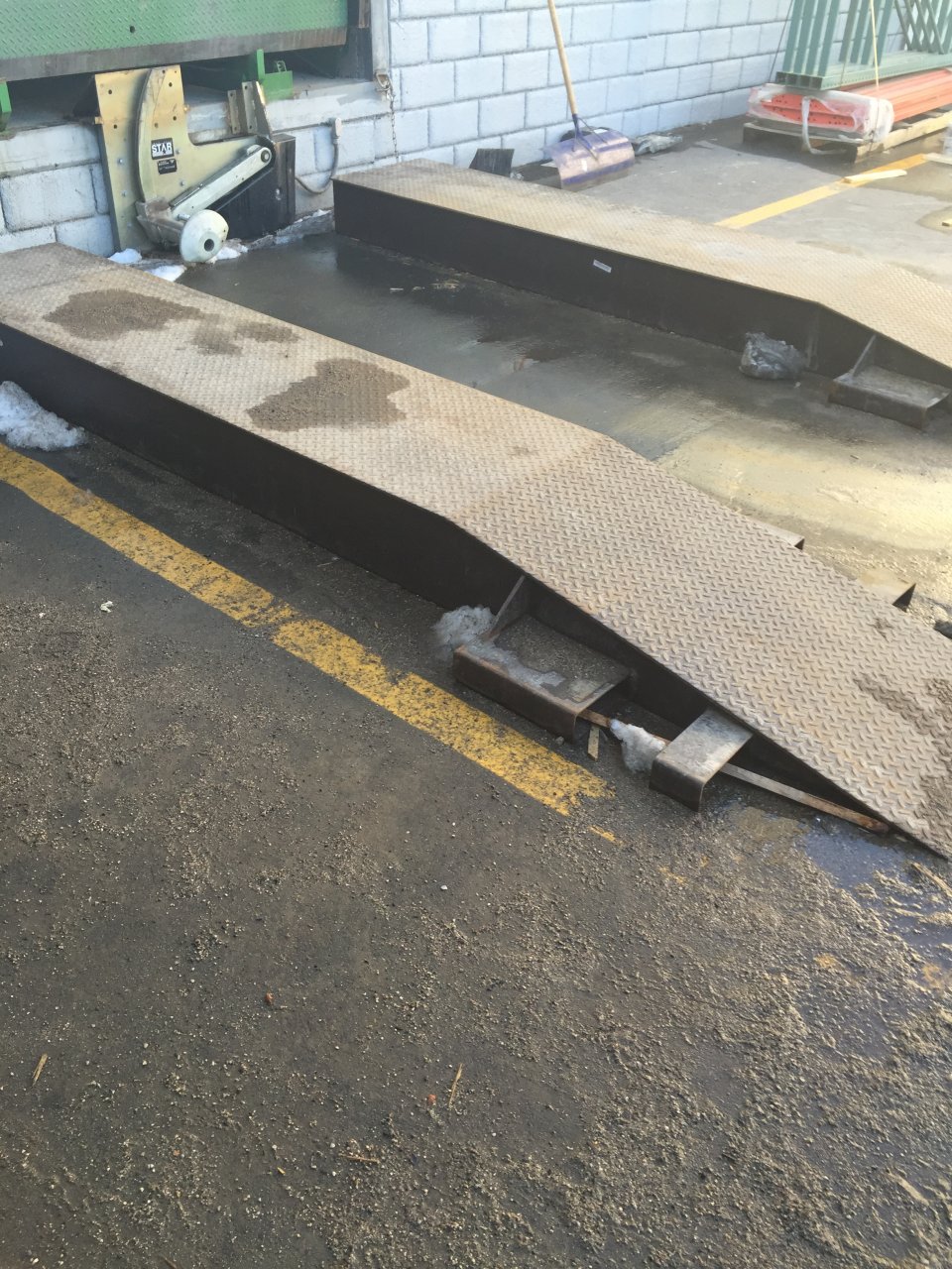

    I have backed up ramps before that we put down behind the rear axle right in front of the dock. That was to get rear loaded by a forklift when pulling a step deck.
    Dominick253 Thanks this.

  7. kylefitzy
    kylefitzy Road Train Member
    4,755
    19,811
    Aug 12, 2007
    Kansas city,Mo
    Here is a picture of the ramps I'm talking about.
