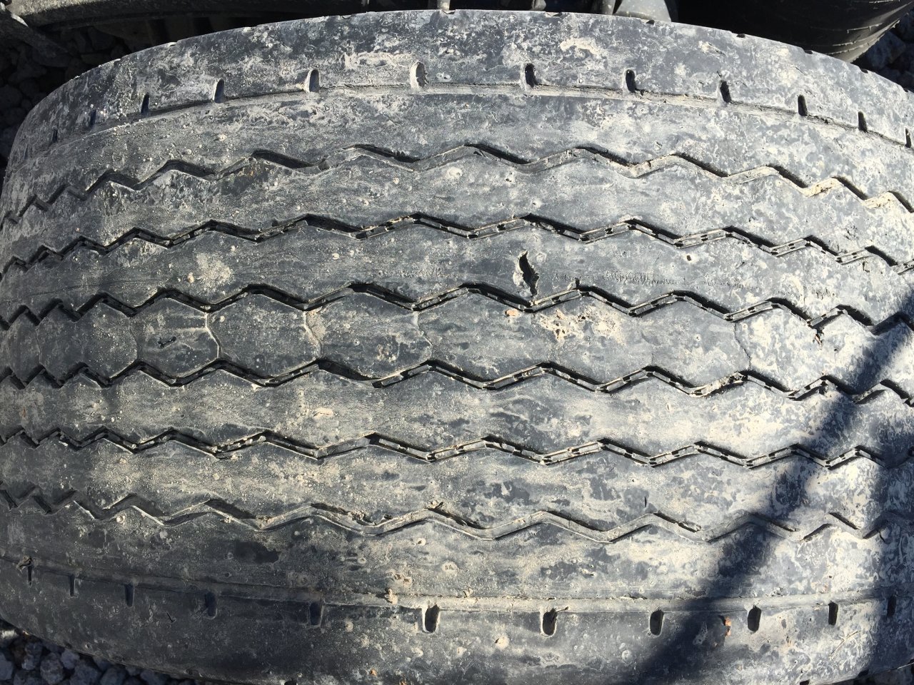

    Just wanted to follow up and say thanks for this information! Really appreciate the time you put into answering / providing some great information!! The pictures you posted are a great help too!
    As it turned out, I was wrong about the type of tread we have... in fact it appears that I have 2 types of tread, and the front axle has more tread than the rear on the truck. This is on the rear axle. Both tires are Goodyear and have a maximum recommended pressure of 120 lbs. cold.
    Would you suggest that I try lowering the pressure, and if so... how much? I haul a dry van with as much as 45,000 lbs in cargo / 78,800 gross, but as little as 17,000 lbs - at any given time. You mentioned weather conditions and air pressure, but does that change with the amount of weight you're carrying, as well?

    Not being familiar w/the Goodyears you are runnin....I really do not feel comfortable making an air pressure guess....However I do feel typicallly manufacturers are going for higher psi...as a way to further better rolling resistance....w/out much thought to traction differences....but that's jus my opinion......course if I were you I wouldn't be afraid to exeriment...and I would suggest in the beginning.
    ..to only make adjustments when cold....specifically after a night/day off--then pay close attention to that tires psi gain when heated under a load....then once you have a pretty good handle on that...u can start playing w/different pressures to see how traction is improved/or worsens under different conditions.....like anything else its a learning curve....be careful..m
