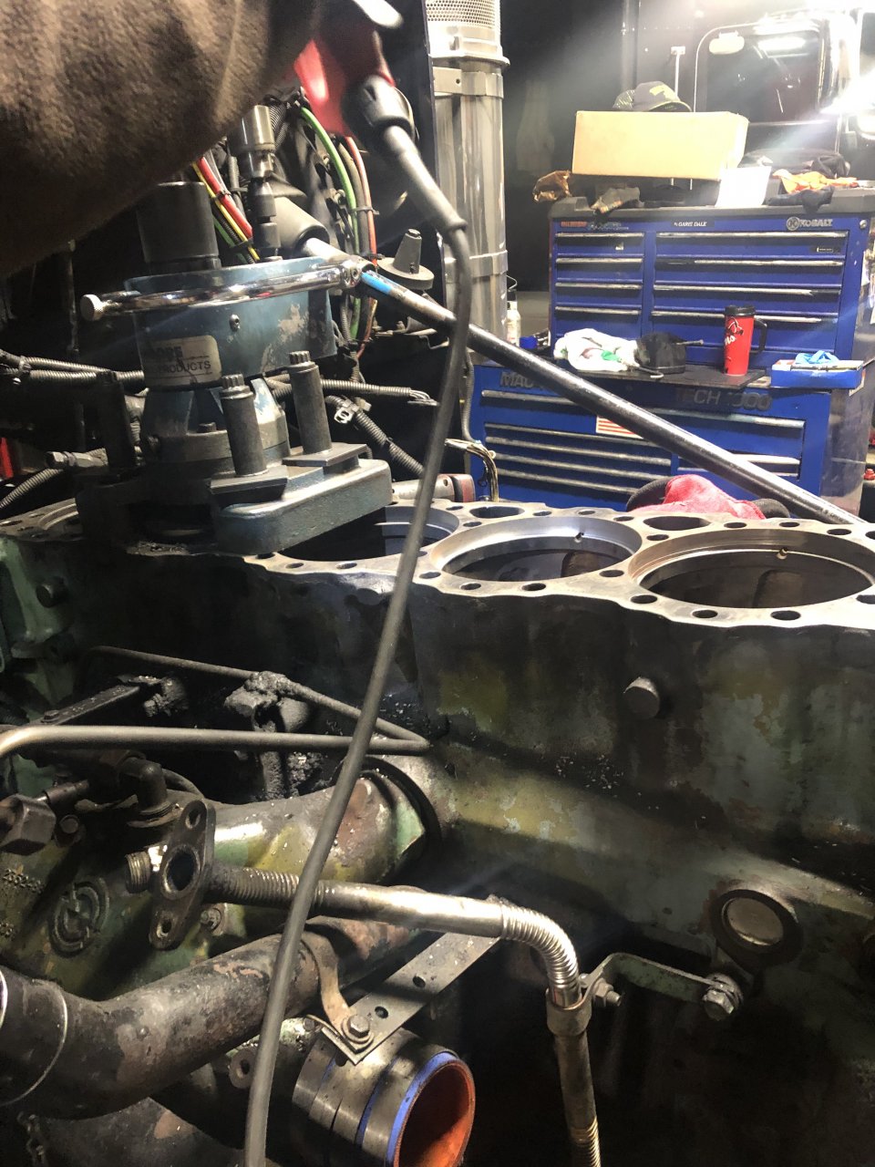

    F1F6FB5F-B115-4694-B9FA-72E21F36CDCF.jpeg I’m still learning. Today I watched my counterbores being cut, and inserts installed. It was very cool, made my day.

    How much did they have to shave off?
    Did they fit the new liners first and check the height with a sled gauge? A lot of guys just cut them and dont even check to set if they need it.

    3 of them needed it, and 2 of them had inserts from the last overhaul. The inserts are 30 thousandths. I guarantee they’re done right, and I got the friends and family discount to boot.We also did the inner cover, and set bull gear, and other gears in today, That also was very interesting, Much easier than the manual makes it seem. I’m sure glad I didn’t attempt to do it myself though. I’m very lucky to get the chance to learn on my own engine, I want it done right, it’s my only and last Truck. A few more things after this job, and it’s done. For a while anyways.
