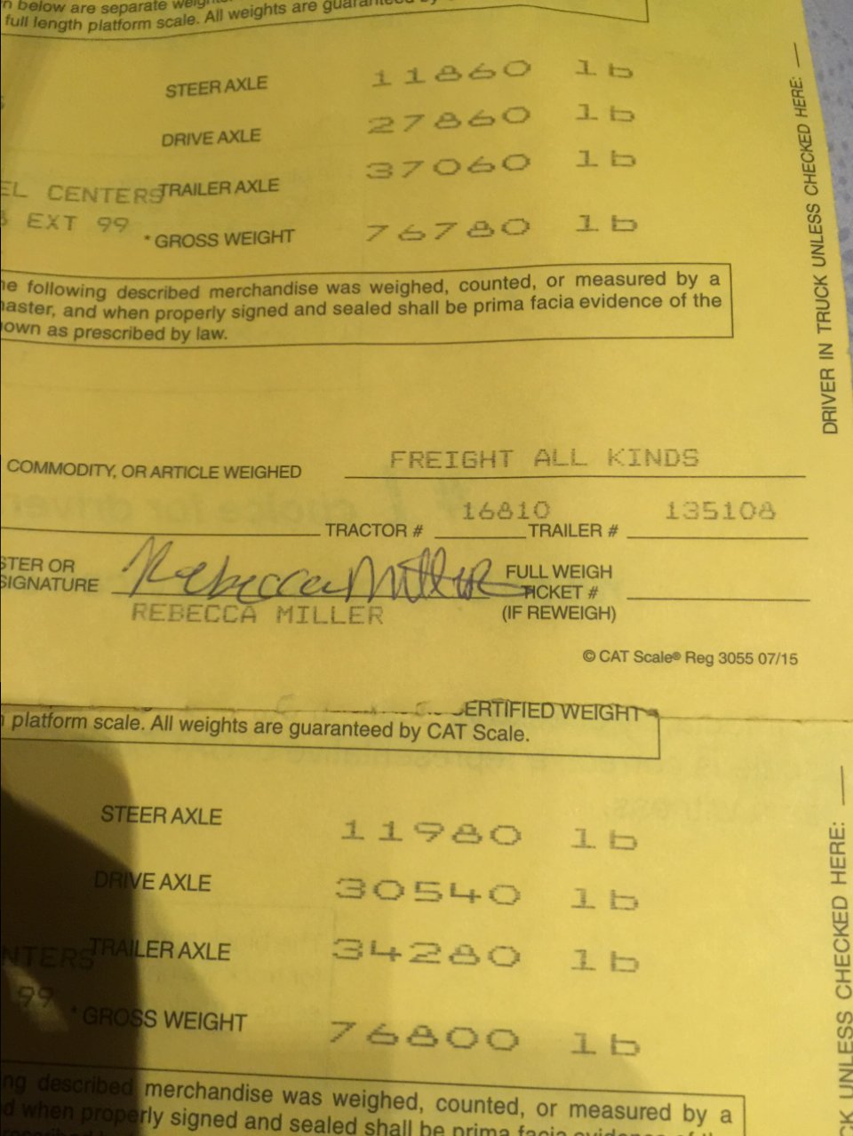

    Funny you should mention that. I've had quite a few of those lately.
    Top ticket was at 41'. Bottom ticket was stretched all the way to the rear. BOL said 42,241. How hard is it really to load one correctly? Must also be listed as unskilled labor lol
    My load home this week came in at 24,400 / 31,800. They sure do ride like #### loaded that way.
    I've got a gauge too and usually it's dead on setting it at 60lbs +/- 5 on the drives. Didn't take the gauge to know those loads we're screwed up lol
