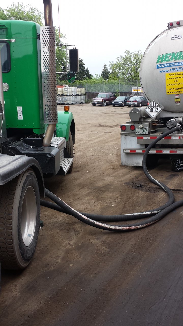

  10. slim shady
    slim shady Road Train Member
    3,468
    14,691
    Sep 14, 2011
    Chicago, Il.
    ChicagoJohn Thanks this.
