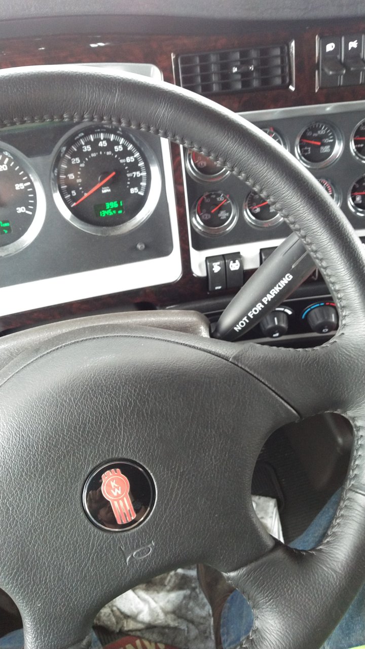

  3. Dave1837

  4. expedite_it
    expedite_it Road Train Member
    1,646
    865
    Sep 8, 2012
    What is the point of your picture? Is that lever that says "NOT FOR PARKING" the trolley valve? The Kenworth I drove for Covenant did not have a trolley valve.
  5. Dave1837
    Dave1837 Road Train Member
    1,403
    4,354
    Nov 16, 2019
    Pennsylvania
    Yes it is. What model Kenworth did you drive
