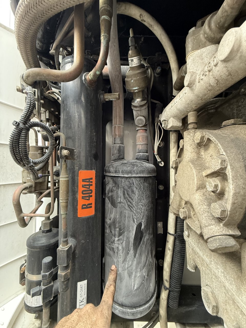

    That's the accumulator tank,it freezes on defrost or heat because the throttling valve is closing and choking off the liquid freon so it doesn't get back to the compressor.That,s normal,after it goes back on to cool mode it will disappear.

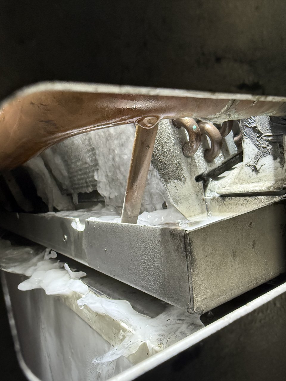

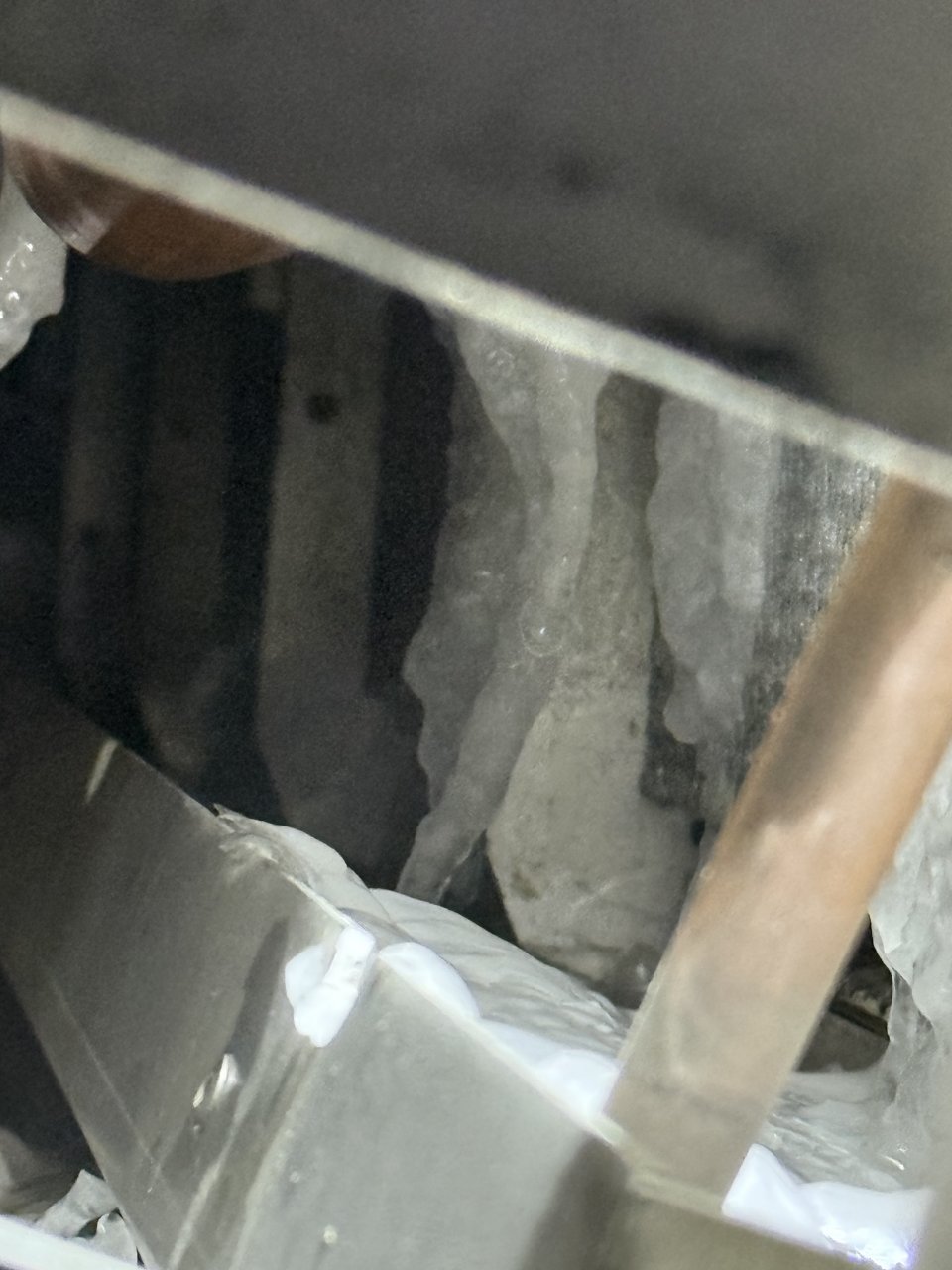

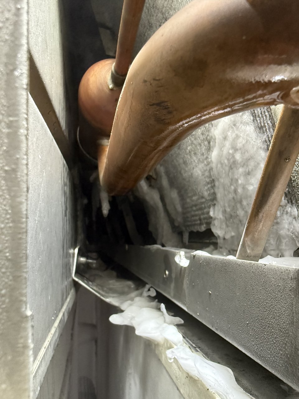

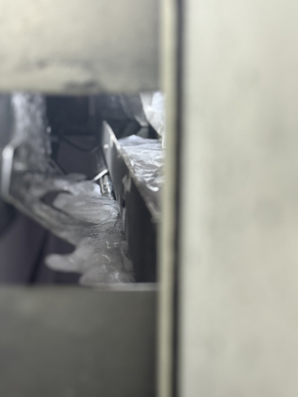

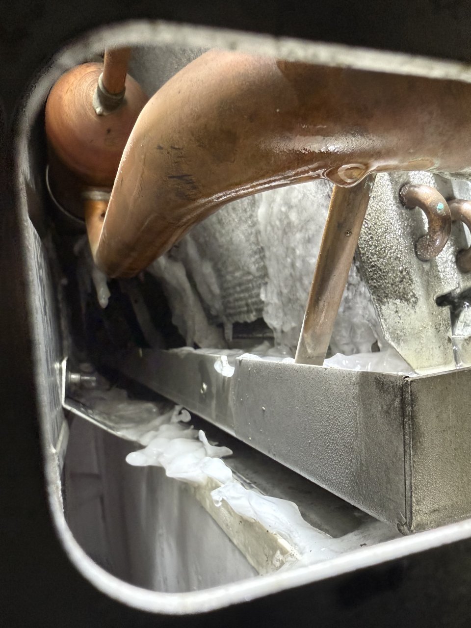

    It was on Continuous mode since friday. Just delivered the load and got some pics of the water tray. And saw only the passenger side of the tray got frozen.

    Well there's your problem.Check the tray when it thaws for debris but the blockage usually happens in the drain tubes right at the top where they are connected to the wall because they make direct curve down and stuff gets stuck there.

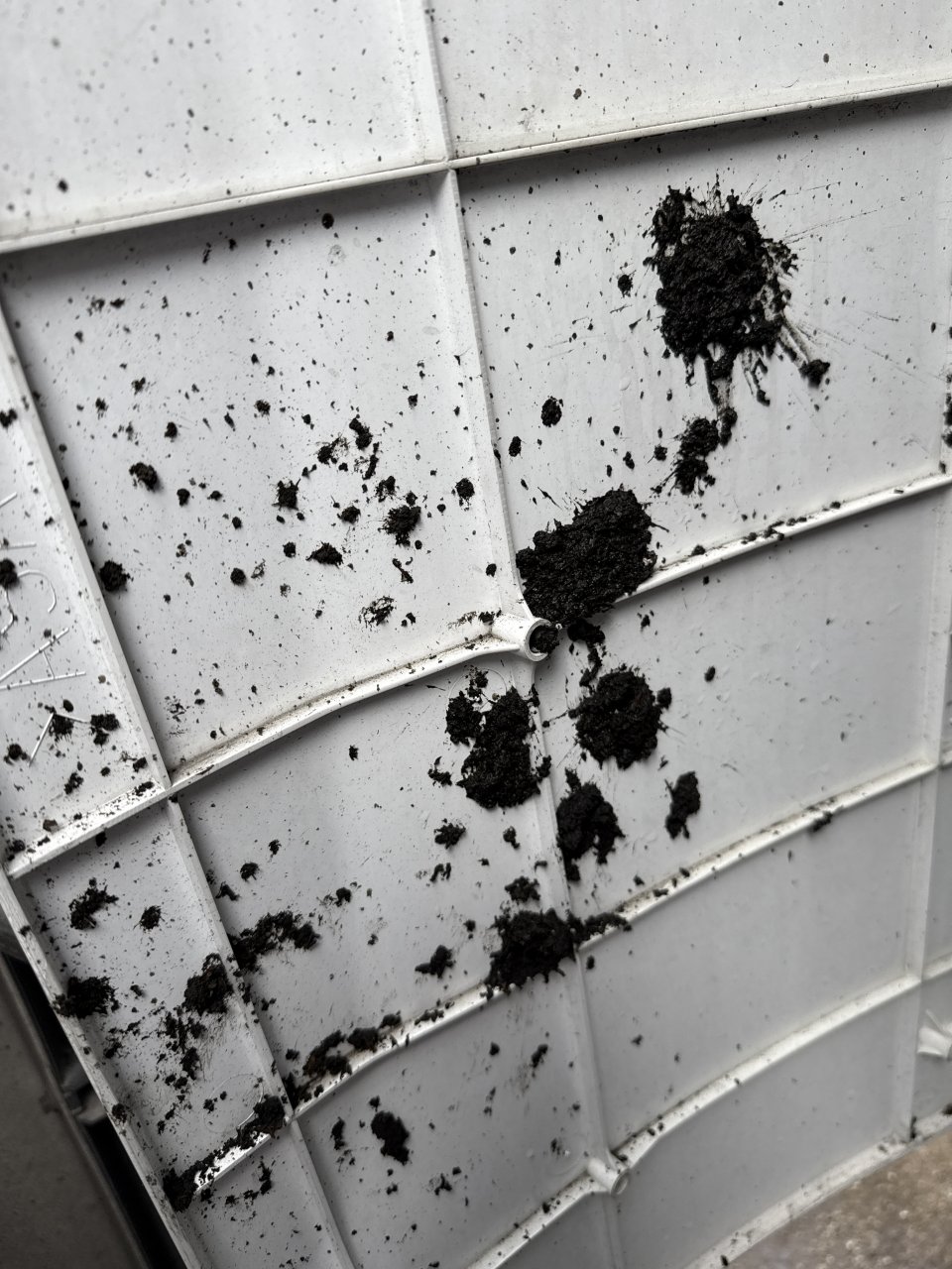

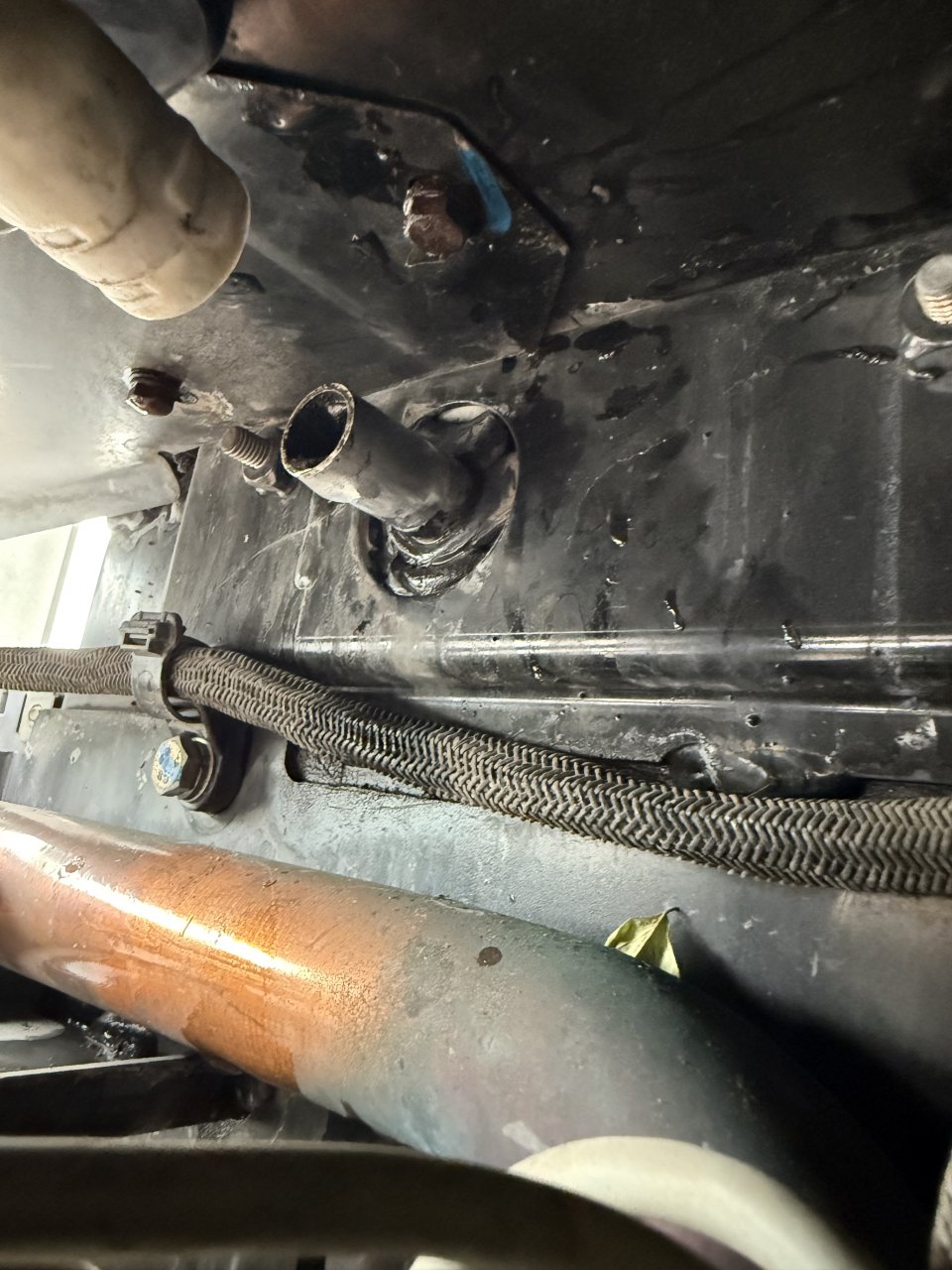

    View attachment 566341 I put the air inside of the drain hose and a lot of dirt came out to outside. Should i put the air on the other side too? I mean to the connector? Or will i get damage if i put the air in it??

    I put the air inside of the drain hose and a lot of dirt came out to outside. Should i put the air on the other side too? I mean to the connector? Or will i get damage if i put the air in it?? image.jpg IMG_4940.jpeg

    Pour water in the top of the hoses and make sure it runs out the end of the hoses.When tray thaws out pour water in tray and make sure it runs out of the pipes.If so it should be good.
