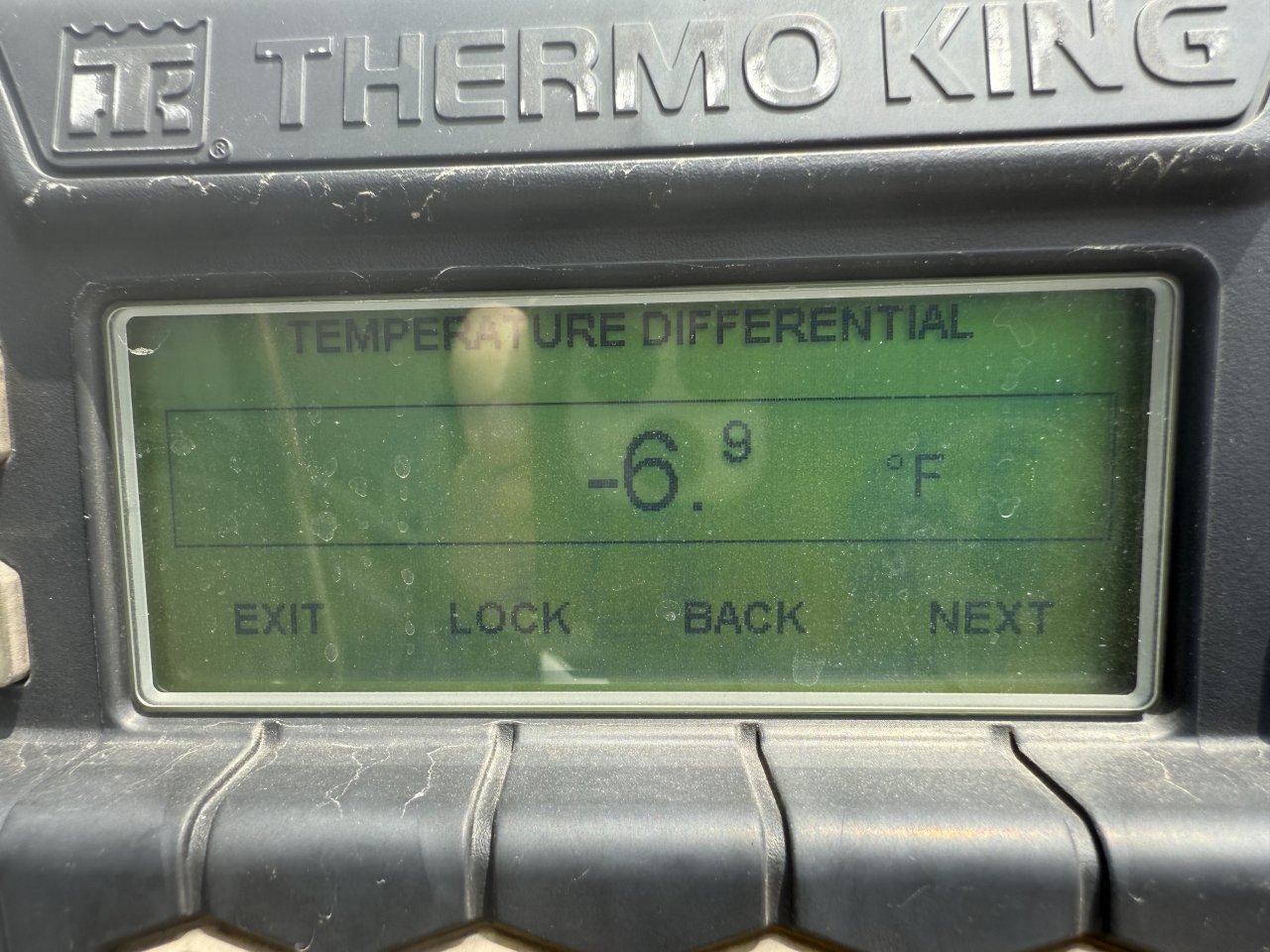

    Hi friends just realized that Temperature Differential shows on -7degrees.i did manually defrost and it rose to 7degrees but it backed to -7degrees again. I am open to any advice. Thank you! IMG_5377.jpeg unit set on 33 degrees continuously btw.

    If the box is at setpoint dont worry about it.

    Looks like settings are stuck on previous load? I’d disconnect the battery for 15 minutes and try again.

    Nope because previous load was 70 degrees but i can still try it if it helps

    If it's on continuous mode and it's near or at setpoint the temperature differential always drops because it goes into modulation and cooling slows down to maintain setpoint.
