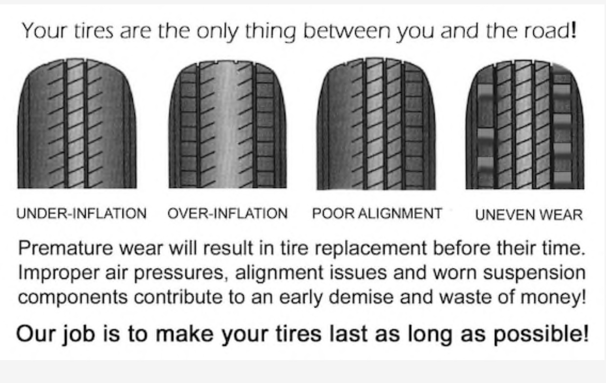

    So you are saying one can put more than the “max psi (cold state)” displayed on the sidewall of the tire? For example, 120 psi (cold) on a tire that says 110 psi (cold) on its sidewall? What source are you getting this information from? I understand people do it and that the tires hold, but my point is that they may develop over-inflation problems as there really is a thing as over-inflation tire wear, not just under-inflation tire wear (image below).

    According to the large motor carrier I was leased to, tire wear on the sides is not an issue with DOT. They only check the tread depth in between the sides (typically 3 or 4 lines). This starts to make sense when there are tires with no tread on the sides such as some Continental tires (images below).
    On the other hand, the middle of the tire really is a problem as it’s bound by the 4/32 and 2/32 (steers) rules. You have over-inflation problems when the center tread of the tire has less tread depth than the lines next to it.
