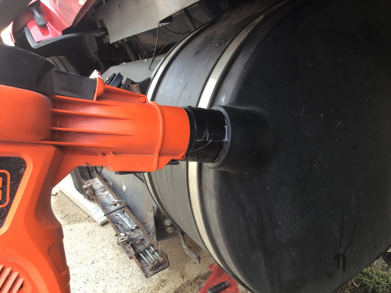

    Hey all. I thought I would share how I drained my def tank. I didn’t really want to remove the tank so I had the idea of using my leaf blower to add a little pressure so it would use the tanks pick up tube to empty it. Of course I had removed the pump module. It takes a while but it works great. Thanks. 53A19686-4B41-445E-902E-6394D184D051.jpeg 26395163-590F-44E5-A49B-35F1204A6594.jpeg B10DD49A-E977-40FD-8E8C-D482D1B927D4.jpeg 26395163-590F-44E5-A49B-35F1204A6594.jpeg

    Great tip but you could have at least put a pan under it...

    Ridge line, I’m getting poor quality def codes. I figured it wouldn’t hurt to fill with fresh. Judge, I tried an air powered extractor that I have but it wouldn’t get to the bottom of the tank.

    2015 Pete 579 does not have a quality sensor in the tank. It uses both nox sensors to determine quality. And yes both have been changed.
