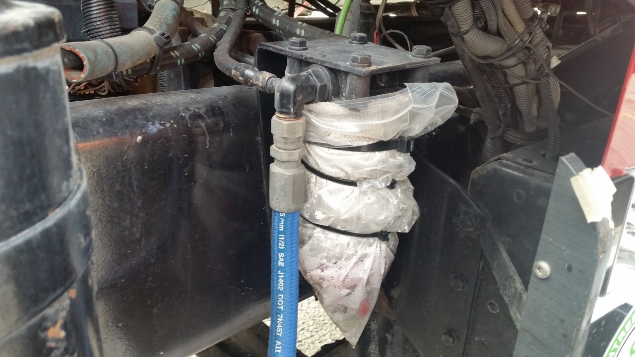

    Don't need to have water in fuel to gell. The paraffin in fuel turns to a wax at certain temps. And clogs up the paper in filter. The trick I do is run blended fuel with additives before you gell. I use howels. I also slip a wool sock over my filters and cover with a plastic bag. This serves as two things, the sock keeps the heat in your fuel from cooling when in filter and the plastic bag keeps the sock from getting wet. I have ran in -30 and never gelled doing this.

    Like this, don't look pretty but works. Make sure you snip a little hole in bottom of plastic bag so condensation can get out.
    tscottme and Lepton1 Thank this.

    I'm going to give that a try. I have tried a sock with hand warmers inserted inside, but that didn't work.
