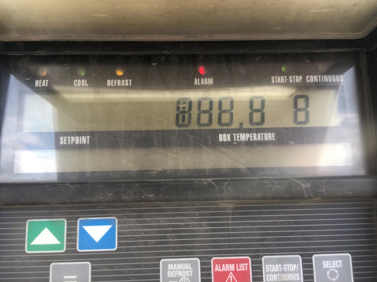

    My Reefer was set at 38° Before the controls and screen locked up like this. It turns on and starts cooling to 38° but the screen never blinks and the buttons don’t do a thing.

    I just replaced the control panel. That fixed it.

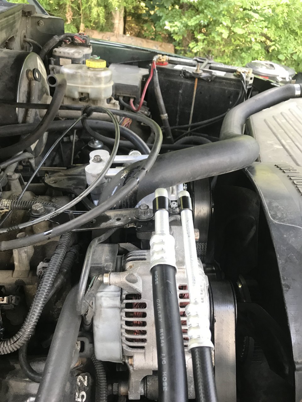

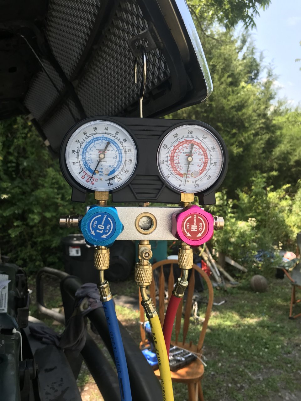

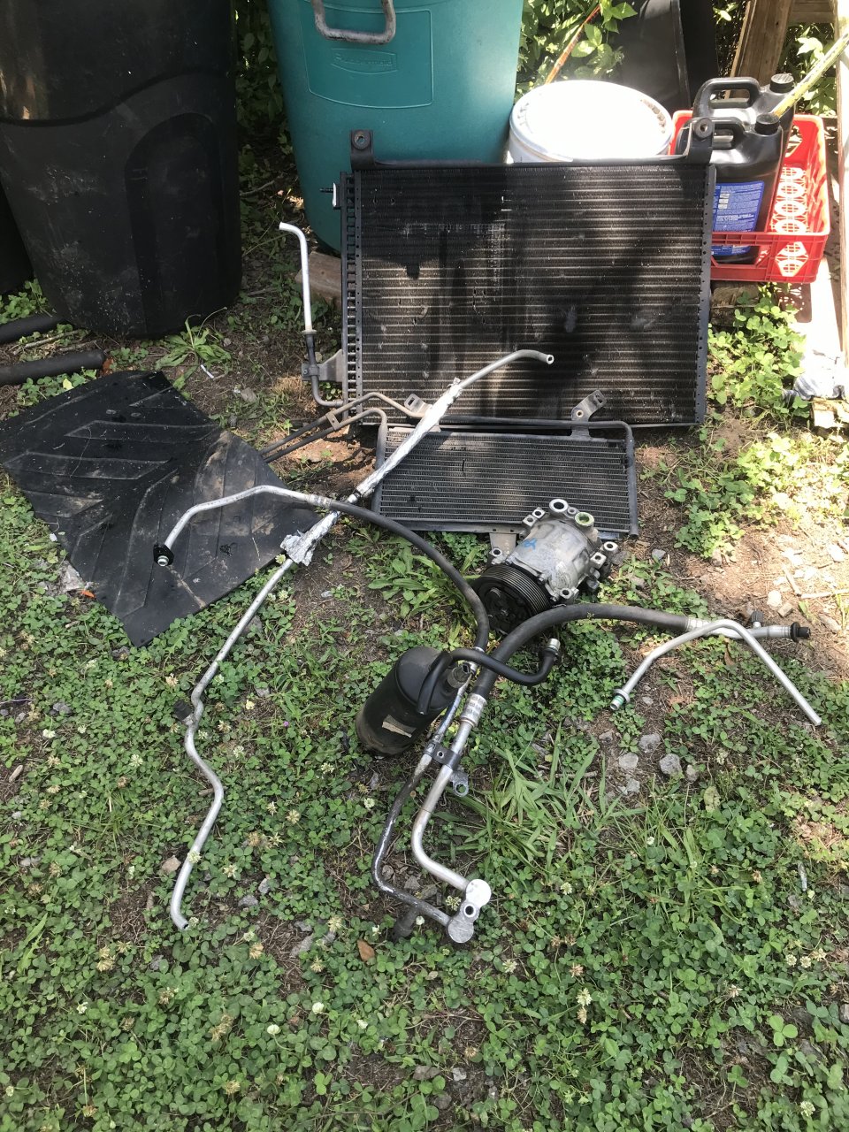

    459EB95B-A2BB-4B22-8B5F-AC841666B377.jpeg 4CBC6EC8-22B5-4C23-B215-9DC53B2FB6C7.jpeg CD018C37-35F4-49EC-98FB-92586FEEBEEB.jpeg 2CD051EB-DC28-4604-9153-6E71C5309B02.jpeg 2CD051EB-DC28-4604-9153-6E71C5309B02.jpeg i just got done replacing all my ac parts. pulling a vacuum and then charging freon. happy father's day everyone
