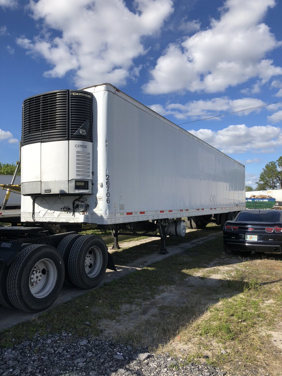

    Earlier this year I made the jump from dry van to reefer. I was leased to a carrier running their pos vans. Never owned a trailer and haven’t pulled a reefer since Pullen Brothers were still in business. I haven’t seen a single thread on used Reefer ownership so I thought since I’ve been drinking HEAVILY and bored I’d share the experience. First off it’s 26 series retired Prime Trailer.. purchased off Craigslist the day after Christmas. It was the 3rd trailer I had driven too see. Unlike the other two the owner spoke English and we ended up striking a deal.

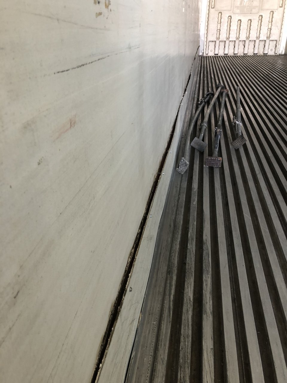

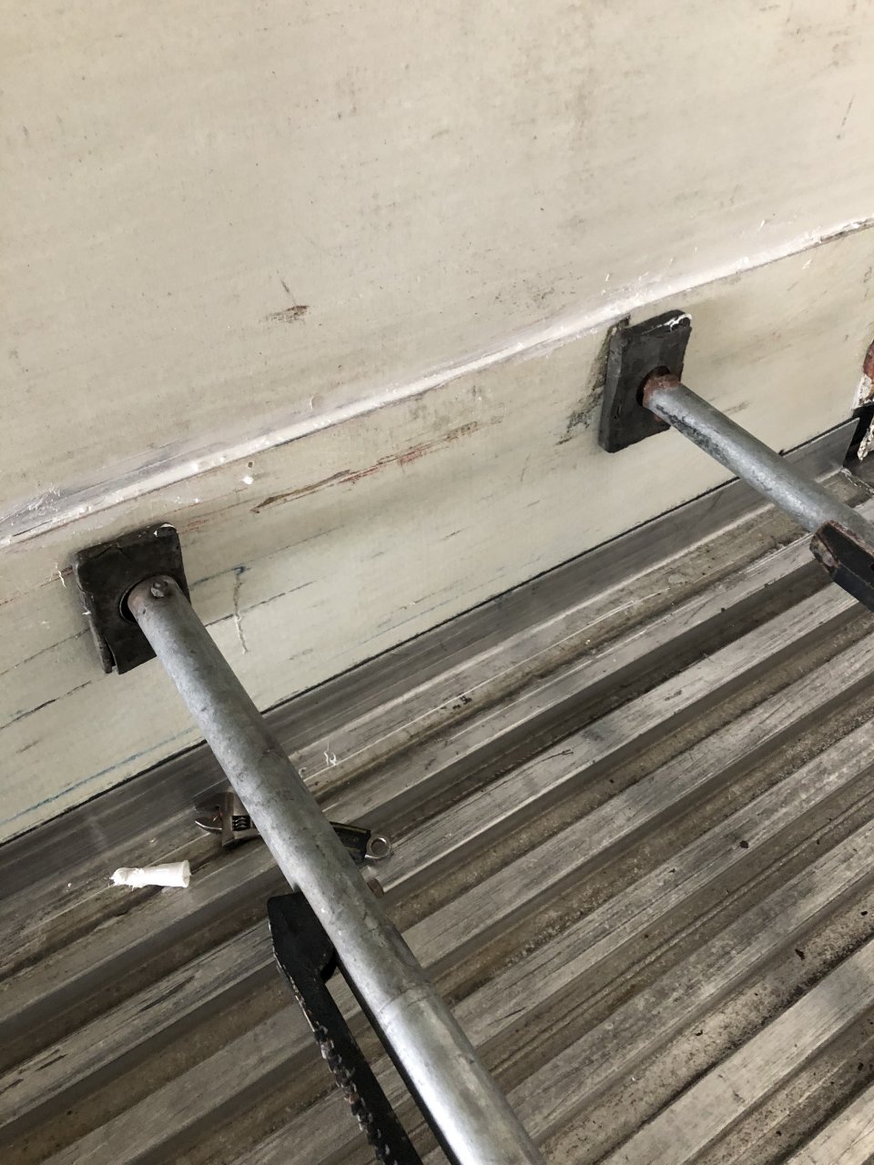

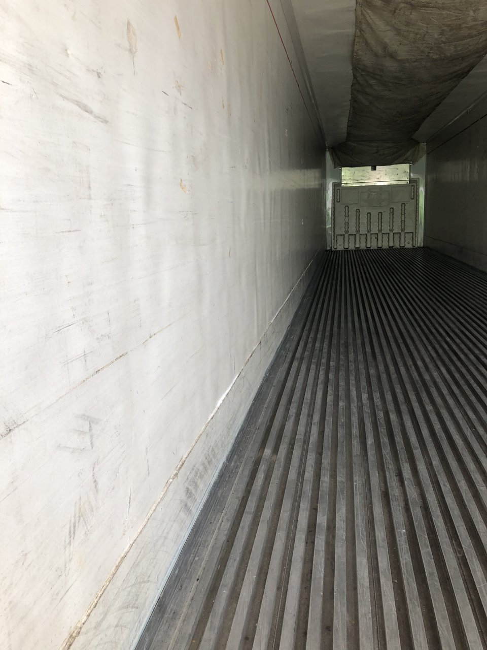

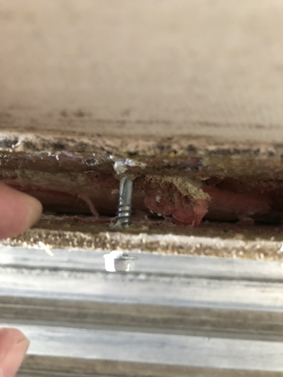

    The bottom part of the wall was also not “load ready” “pickup load and go” like seller claimed. There was ####ing screws sticking out!!!!! 6 bottles of gorilla glue caulk and 3 days later she was ready to go.

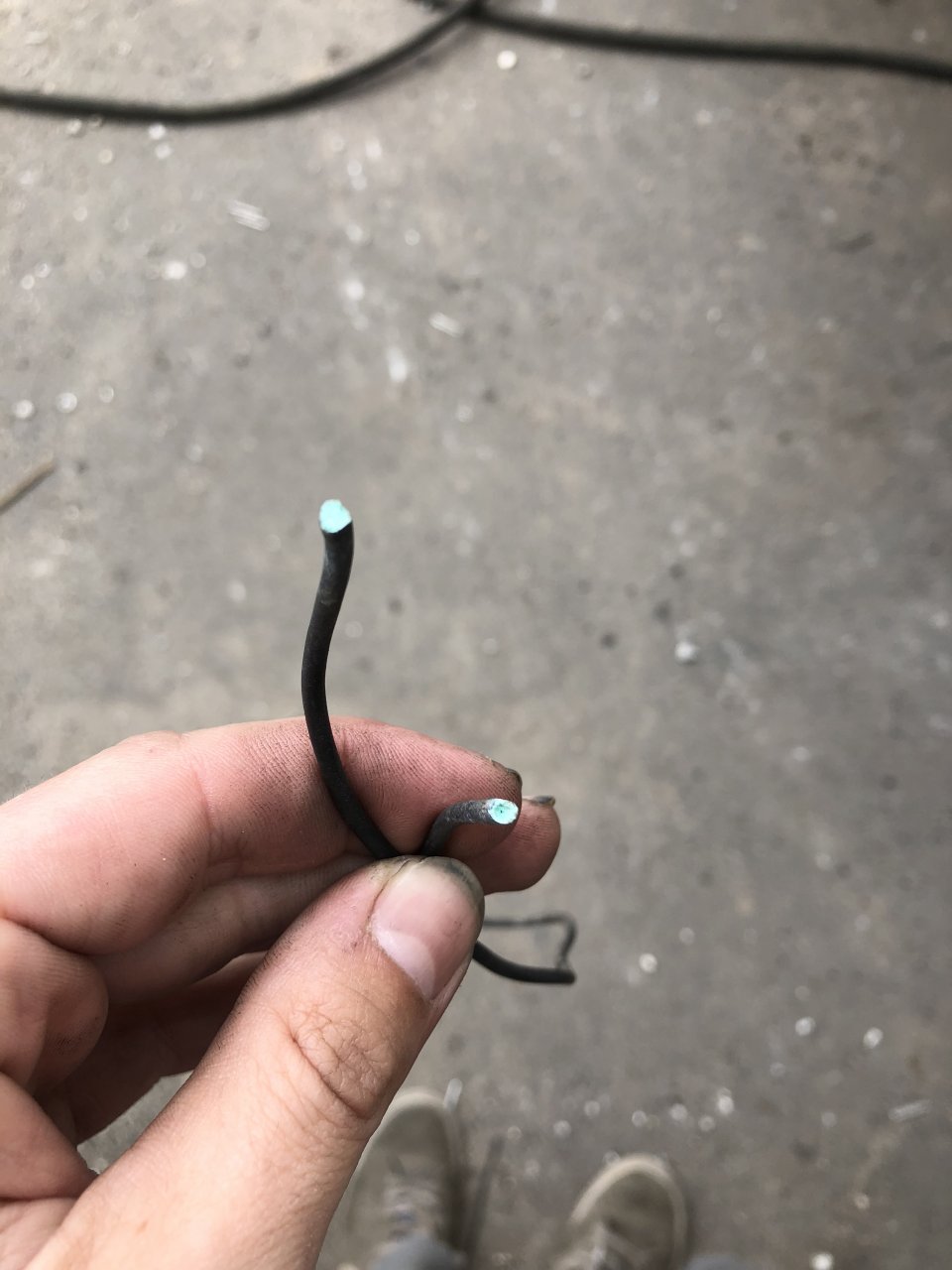

    Week after all this I realize my ABS isn’t lighting up anymore during Pretrip. It goes back to mechanic. Main wire powering ECU was corroded. And not just a portion of broken wire. We’re talking a foot plus of straight corroded wire. Cool though. I think maybe $100 fix.

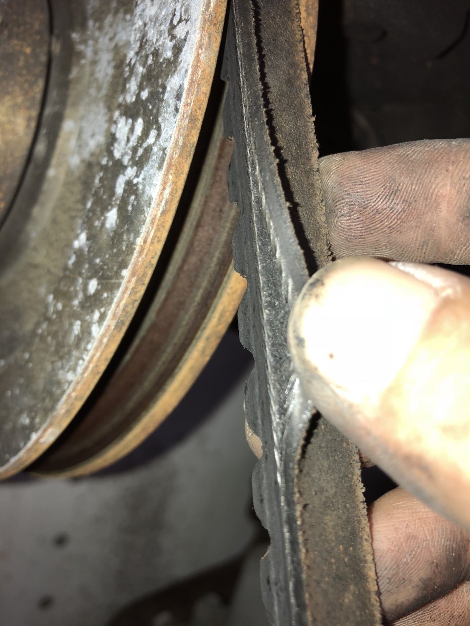

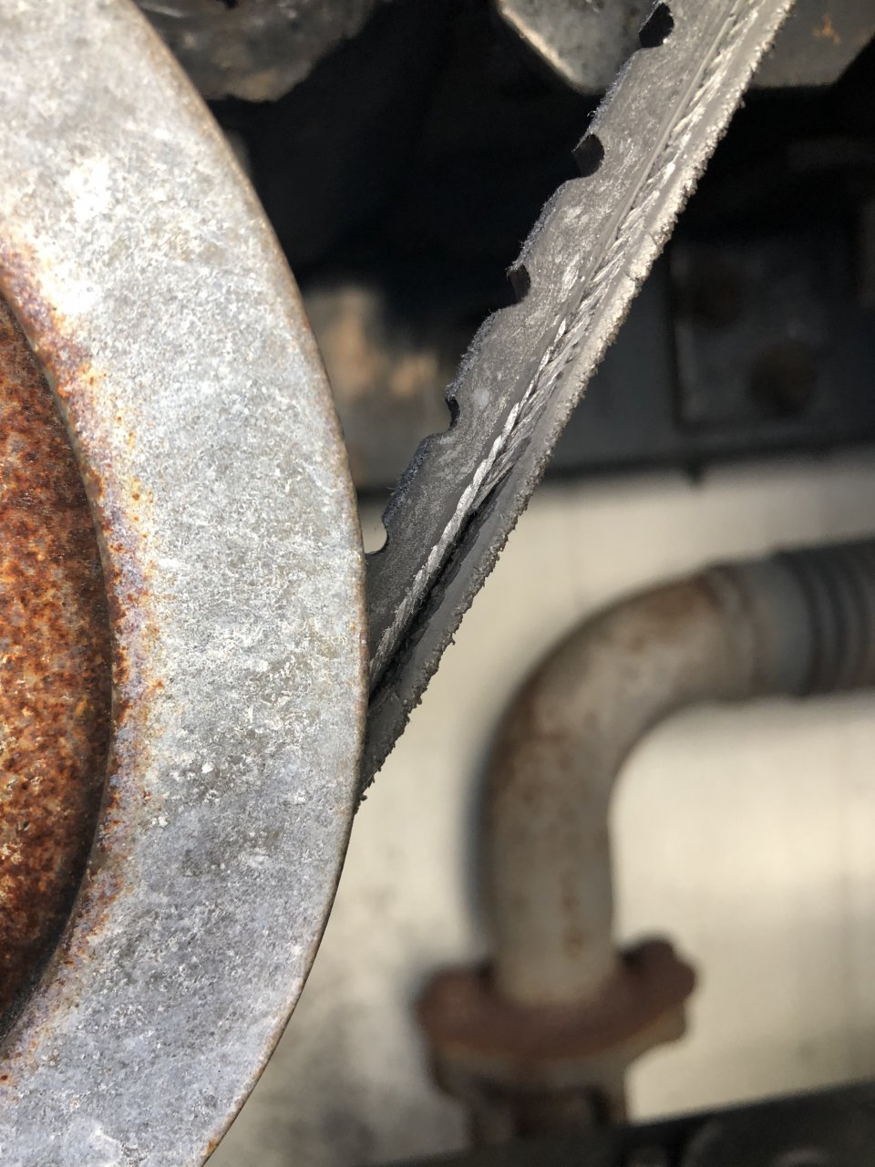

    Not even 2 weeks later I’m pretripping unit and realize the fanshaft belt is splitting.... WOW... WTF..... Remember when I first bought it how I wanted all the belts replaced??? It holds for my load and it gets replaced. Tech says the pulleys were extremely misaligned. More money. This time I end up buying a spare oil/fuel filter. And spare belts. More money.

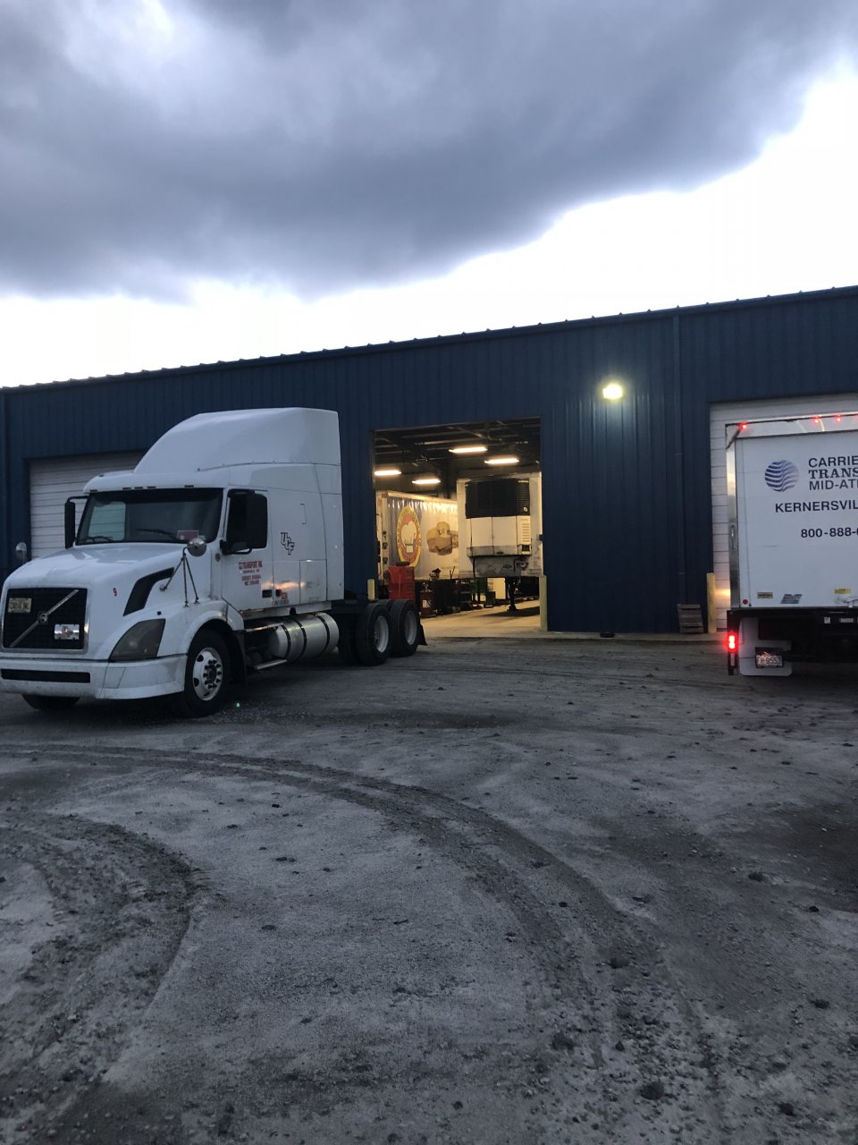

    Next big fiasco happens in Florence, SC when I walk out of Iron Skillet and realize the return fuel line snapped and it’s pouring fuel everywhere. My drives tires are soaked and so is the asphalt. Where the line broke was directly underneath one of the cross members. It’s unreachable. I don’t have 1/4 brass tube2tube fittings or extra hose and neither does shop. I’m about to lose my #### so I cave in and call Carrier for emergency service. While I got raped the tech spent the full 2 hours of after hours service and showed me how my compressor shaft seal is leaking badly.. I knew my compressor oil was getting lower but was in denial. How much is that to get fixed??? $2000. Wow!! Of course the main mechanic in Florida gets it done for $1093. That’s the new seal, new oil.. latest software update (No more locked out Prime BS settings), belt adjustment, and full Freon recharge.

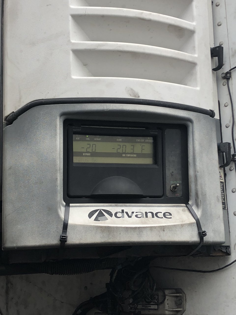

    I don’t do Ice cream... this is a 2008 Wabash Carrier Ultima XTC. I book a Negative 10 load... when I get to US Cold Storage I’m informed there is Ice Cream on load and set unit to Negative 20.... GREAT. No way is this POS gonna hit set point. Not even 20mins later she’s below set point. Unbelievable.
