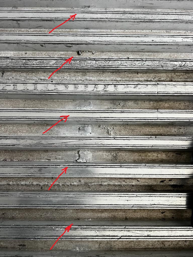

    Utility trailer has hidden corrosion bomb. Do not buy it.
    My friend have Utility trailer from new. In three years aluminum floor start developing corrosion holes. Dealer says they aware about issue, it's because aluminum reacts with underlying wood anti rot treatment chemicals. Nothing they can do or will to change in manufacturing to improve situation.
    will post pictures later.

    -4150357085663798176.jpg Here is photo i promised.
    Holes developed all across the trailer floor where aluminum touches wood support. Slime alike substance with strong acid smell and reaction with backing soda coming out of the holes. 3 years old trailer. Would you buy it?

    my 2010 has 3 plates welded in and some square stock welded into the ducts from the same thing, also the chunky weight I haul doesn’t help but I still won’t buy another utility
