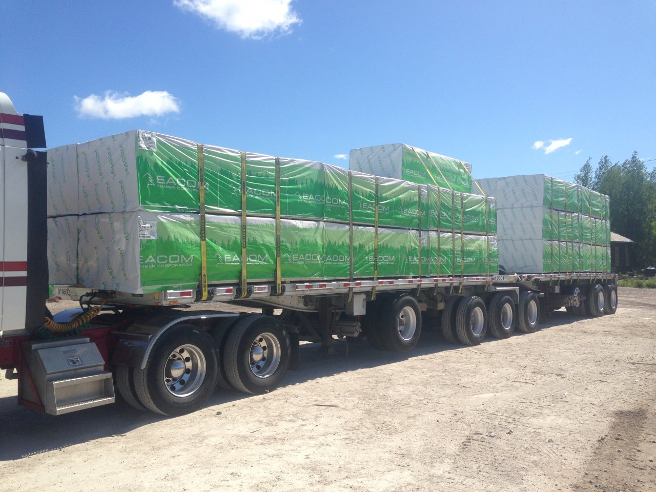

  10. TripleSix
    19,142
    133,833
    This is Rontonio's rig. Empty, he should be pushing 90000 lbs. Anyways instead of looking at this as a truck and 3 trailers, look at it like a truck and a trailer with 2 really big spreads, to spread a lot of weight out into a much larger area to prevent damage to the roads and bridges.
    It's like having a 6 axle tractor with a spread pulling a 5 axle trailer with a spread. Same concept of @w.h.o's rig, just spread out more.
