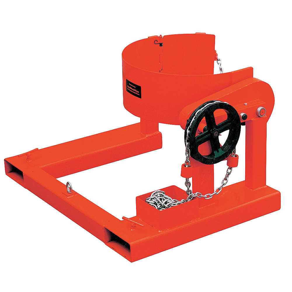

    They make lifting devices fit drums. Look them up on the inerweb
    Klleetrucking Thanks this.

    Thanks, I've been on the web and there's plethora of lifting devices. Being the frugal (cheap) guy I am I wanted to fab something myself. This drum will only be lifted in/out of the pickup maybe 3 times a year.

    Kinda rethinking the tab idea and pondering fabbing up a scissors type arrangement.

    Sorry I meant to say look some up to see if you can fab something. The scissor type just look like two pieces of flat iron bolted together, shod be easy to make.
