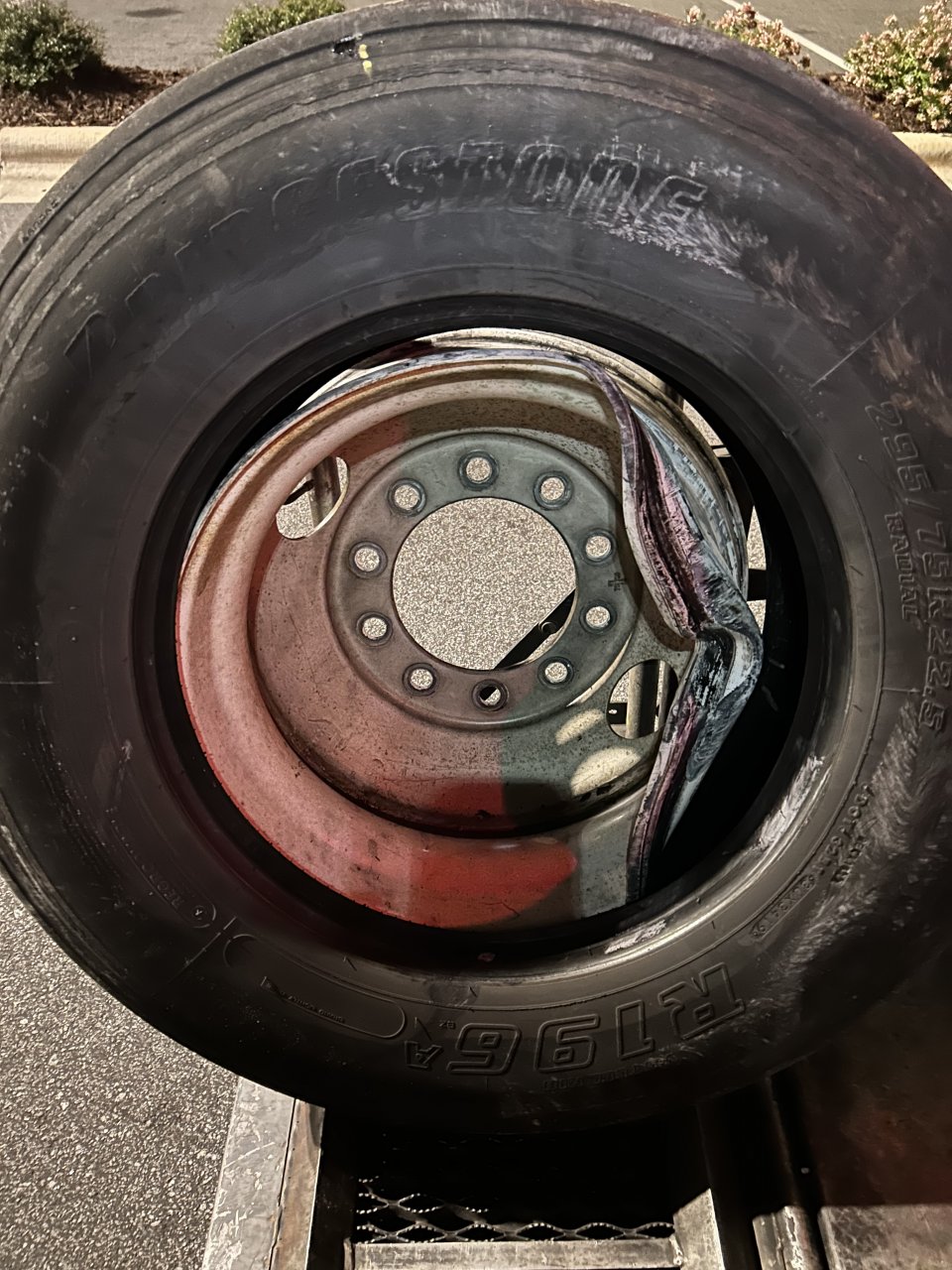

  10. Big Road Skateboard
    8,002
    46,907
    May 2, 2021
    I see where it looks like they put the jack so they could get to the lug nuts
