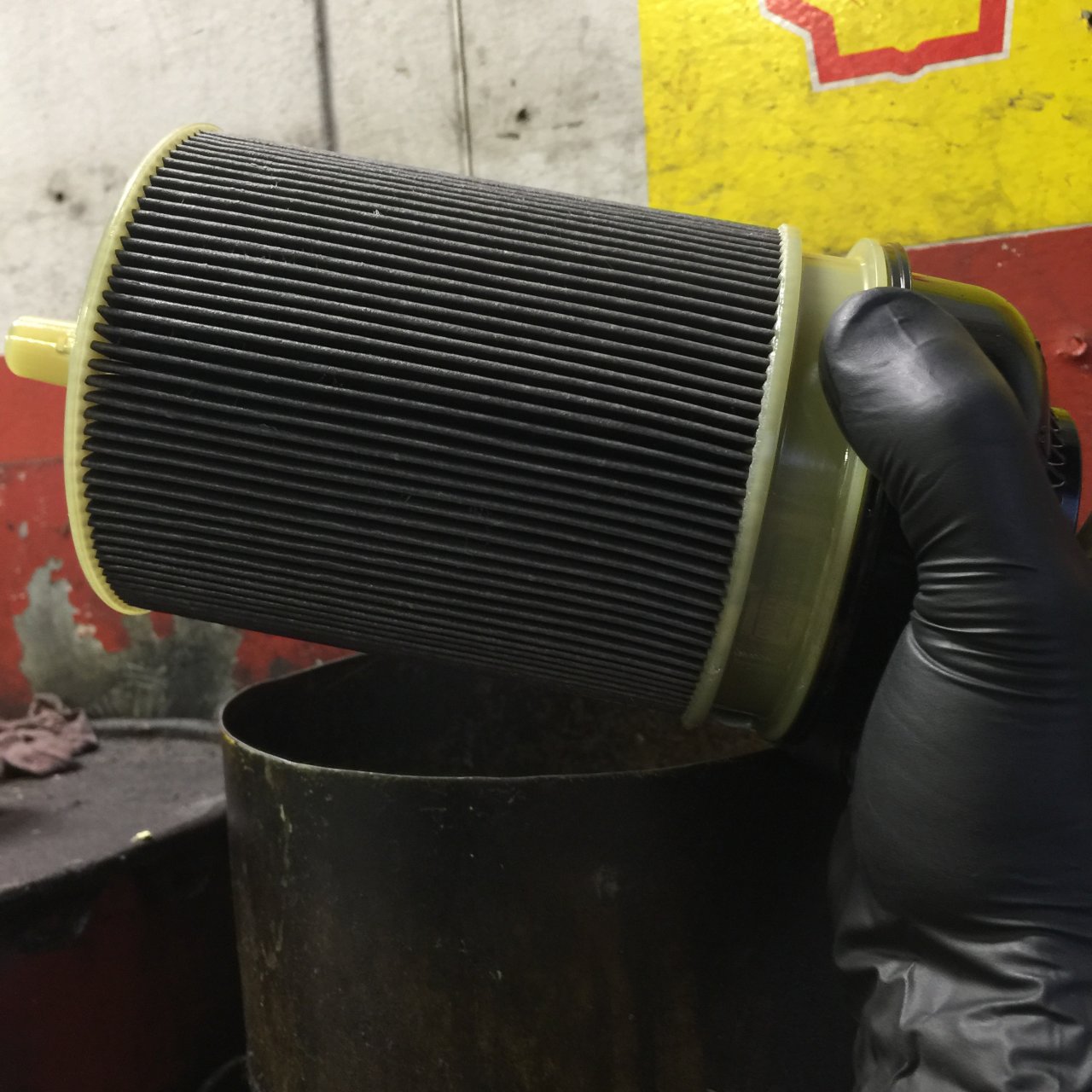

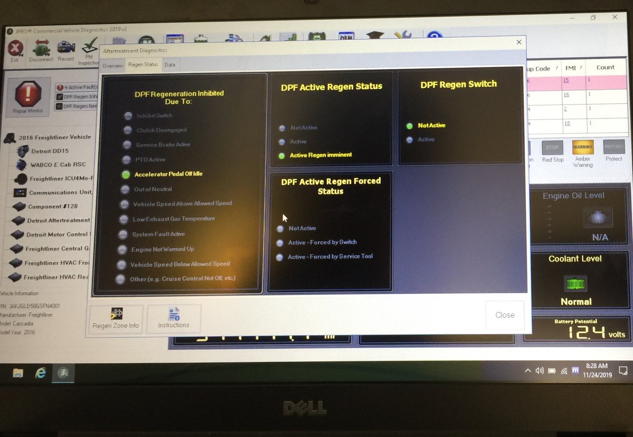

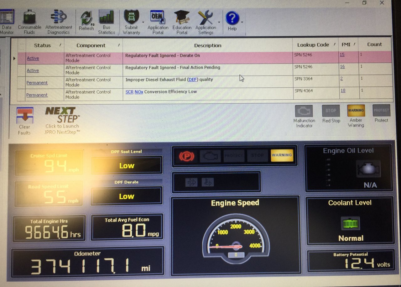

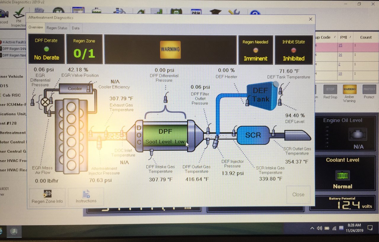

    #3 truck update.
    So my truck threw a few codes and the main one being low quality DEF. It derated 25% and limited my speed to 55mph.
    Dave and the driver of truck #2 helped guide me and the main idea was that I got some bad fuel, and I let my DEF tank get too low.
    $100 to change the fuel filters, and $190 to change the DEF filter. The tech working on it told me it would be $90 to plug the lap top in and see what it said. I said “how about $20 cash?” He said heck ya.
    He showed me page after page. One of the interesting pages was he could see my floor mat was under the accelerator pedal and it was throwing it off by 1%. That’s kinda gnarly.
    It showed a Regen was imminent, so he forced it, and explained a few things to me.
    I’ve gone 350 miles and no codes have come back. The truck is definitely running smoother than ever.
    The truck Regen’d in the first few days after I got it, so this is the first one since the middle of August. I don’t idle much. I use the apu or just shut the truck down.
    Here’s some photos.
