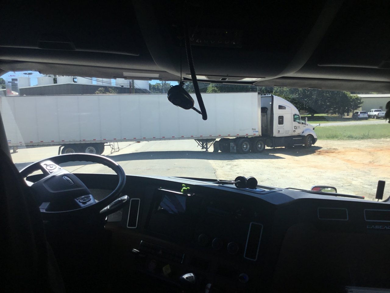

    383ECF9E-2D31-4B5F-ADD0-2C2D3B8A86BB.jpeg New crapcadia life hits a snag. Driver said it won’t go in gear. Offering my limited experience we did the turn everything off and try to reset ,that didn’t work so when he is on the phone with home office they have him go through the motions again when I noticed the driveshaft spinning. I yelled to him call a wrecker it’s not a transmission problem. I got to spend 5 minutes explaining on the phone how this truck has real problems and isn’t being driven anywhere. Everything looks intact and the driveshaft spins and turns the input shaft on the power divider locked and with the power divider locked still nothing happens. This is going to screw my 14 really good.
