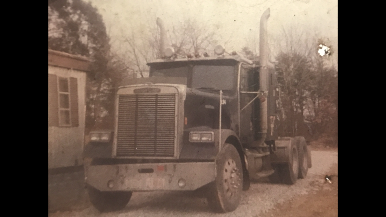

    Well I'll get called liar for this, buy pop's was easy on the pedal. Seen his joints go a million miles. Now he had no issue with grossing 100-150k running small and big cam. 5/5.5 mpg pulling doubles, but seen 7 pulling spread. Had no issue making it boogy once in the hi side. Them 855 Cummins of his always had that choppy idle like the KTA. But in his game back then it helped being light. Guess that's why they called him Mr. Shinny Wheels. He was a sick sob that was meticulous with mantaince, didnt drive hard, but expected everything out of a piece of equipment. Some day I'll have a big cam, just to replace that childhood memory of that sick SOB's cab shaking back and forth. Thank god he didnt drink coffee.
