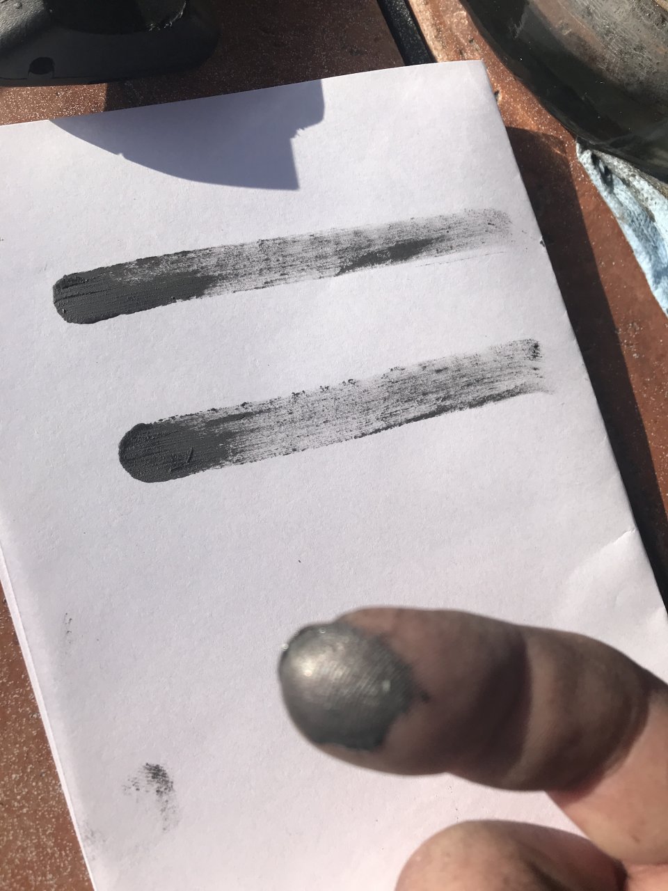

    Both rear ends have about an ounce or two on the magnetic check plugs.
    No history of rear end work .
    What say ye all?
    Truck has 1.2 million miles.
    No fragments, just this FERROUS OOZE (great band name).

    Probably depends on how long it takes to build that much up, but I think I'd just run it.

    Run it....

    When it looks like never seize pull them out.

    Edit. I assume your check regularly and the small hair fragments are normal. But if it looks like never seize in one service interval. I would pull them.
    Hope that clear things.
