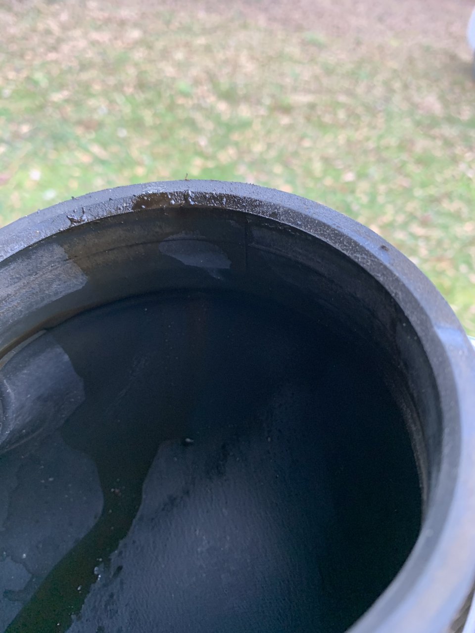

    I do have a question. What would be causing oil in the intake?

    Normal. Pcv system will deposit it there...
    Thru little hose that goes to the valve cover.
    Do you have a good 3 jaw puller for the balancer? There is 3 flats on the hub of the balancer for the legs to pull from.
    Crank bolt is 24mm (almost like a 15/16") and real tight..
