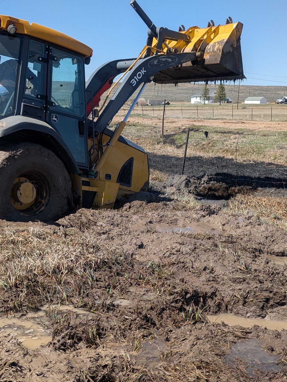

    I shouldn't thank that, but I'm gonna!
    You want a pull?
