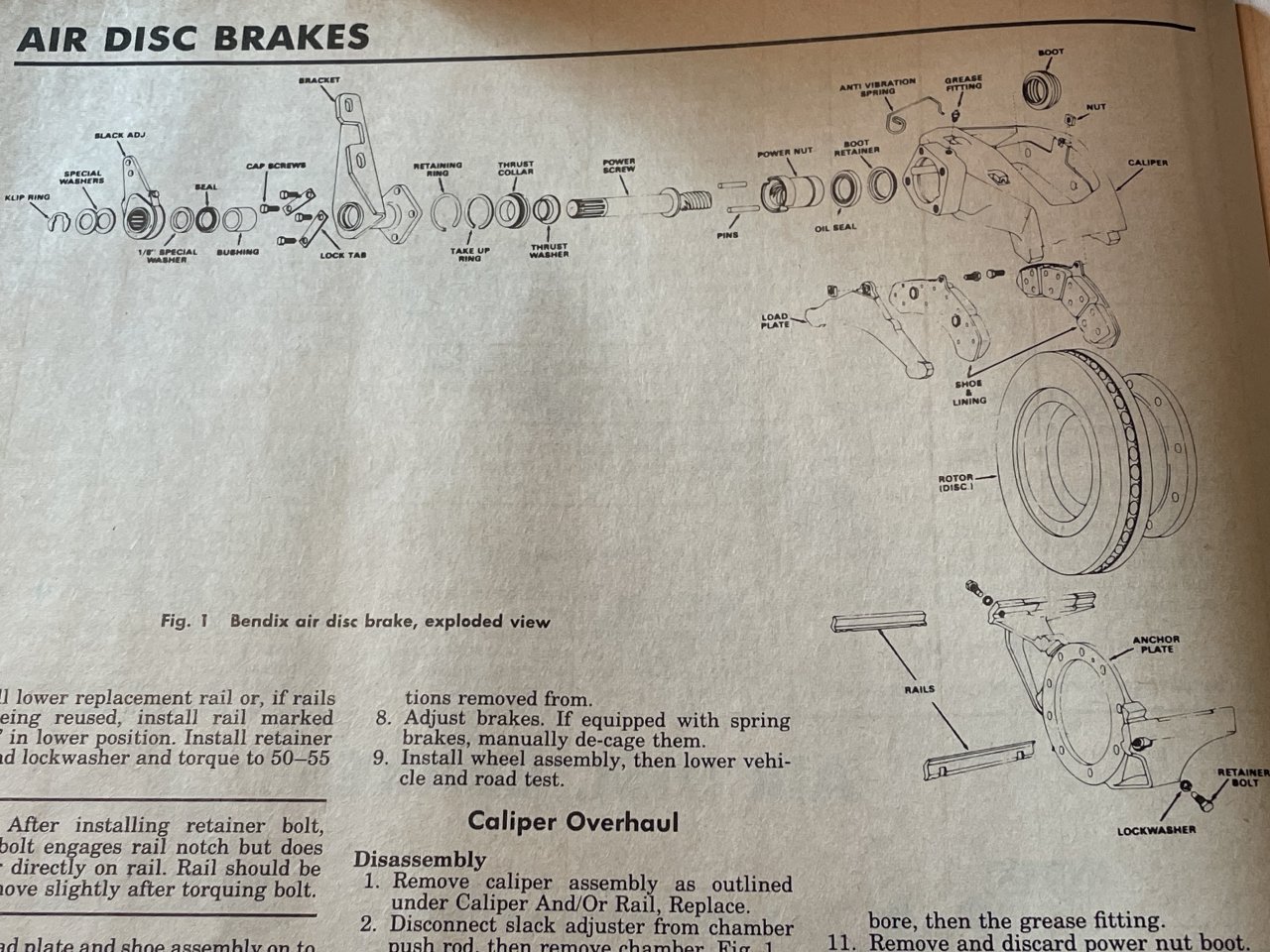

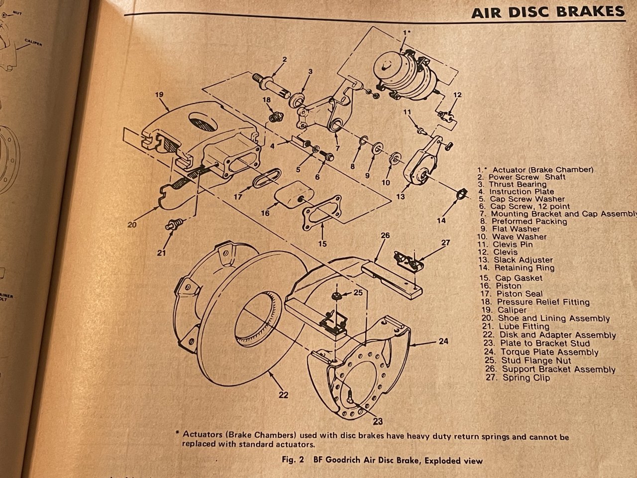

  8. OLDSKOOLERnWV
    19,320
    292,038
    Not really familiar with them. Was looking in my library, anything here look similar…?
