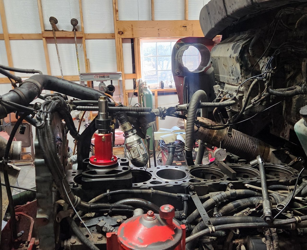

    You have the top and bottom out of that block?

    No sir, just the top.

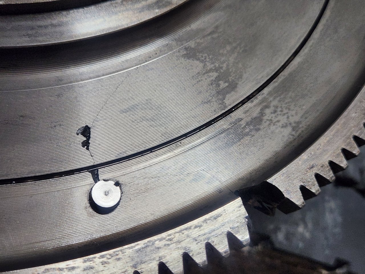

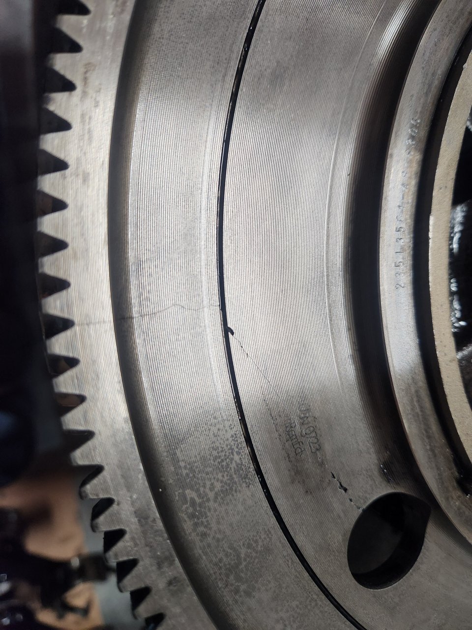

    Great resolution pictures - I can see where @wore out explanation of ‘drop shipping’ could explain - but wouldn’t that have been evident on installation?
    Or would a drop weaken the gear without visibility?
    Sorry to see that - at least , like you say - didn’t grenade 1,000 miles from your home 20.

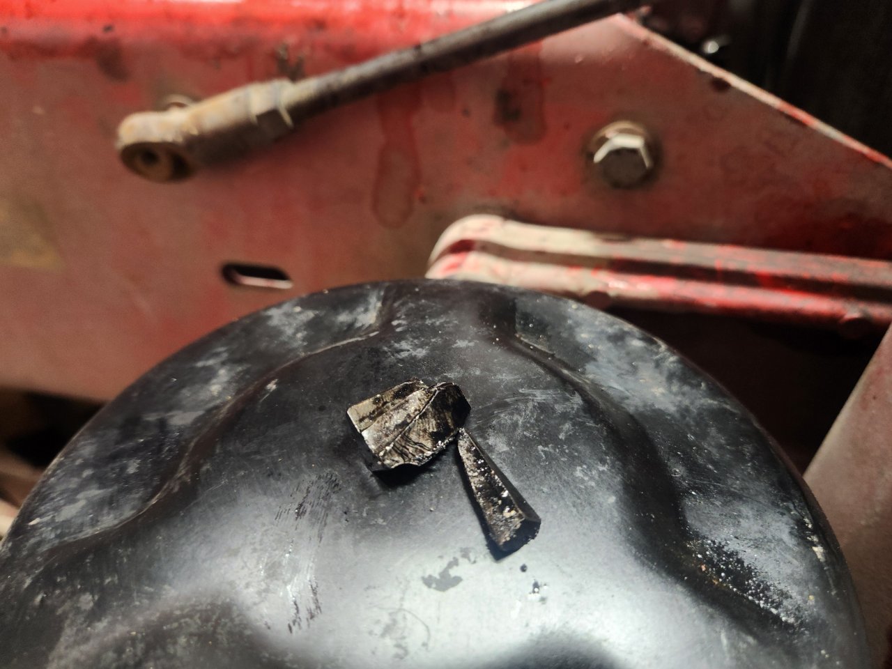

    Any signs that a valve hit?
  8. Big Road Skateboard
    7,332
    41,804
    May 2, 2021
    No sir. Even when it trashed the gears, it didn't have enough damage to get out of time. Never had any valve damage.

    Not having cut a block in 25+ years, that first hole was a bit nerve racking. Took my measurements, cut, measured, rinse, repeat.
    Couldn't trust my measurements enough to just cut. So I'd pull the tool, drop the liner with shim, torque, check protrusion, pull the liner, and reset the the tool.
    Took me three hours to cut the one hole last night. Think I've got the process backbdown. Hopefully today goes quicker.

    Hey, at least you are inside now! Weren't you in a shed the last time you had it apart?
  11. Big Road Skateboard
    7,332
    41,804
    May 2, 2021
    Yeah, I was in the hay barn last time.
    I still haven't built my own shop yet, just lucky to have a few friends in higher places.
