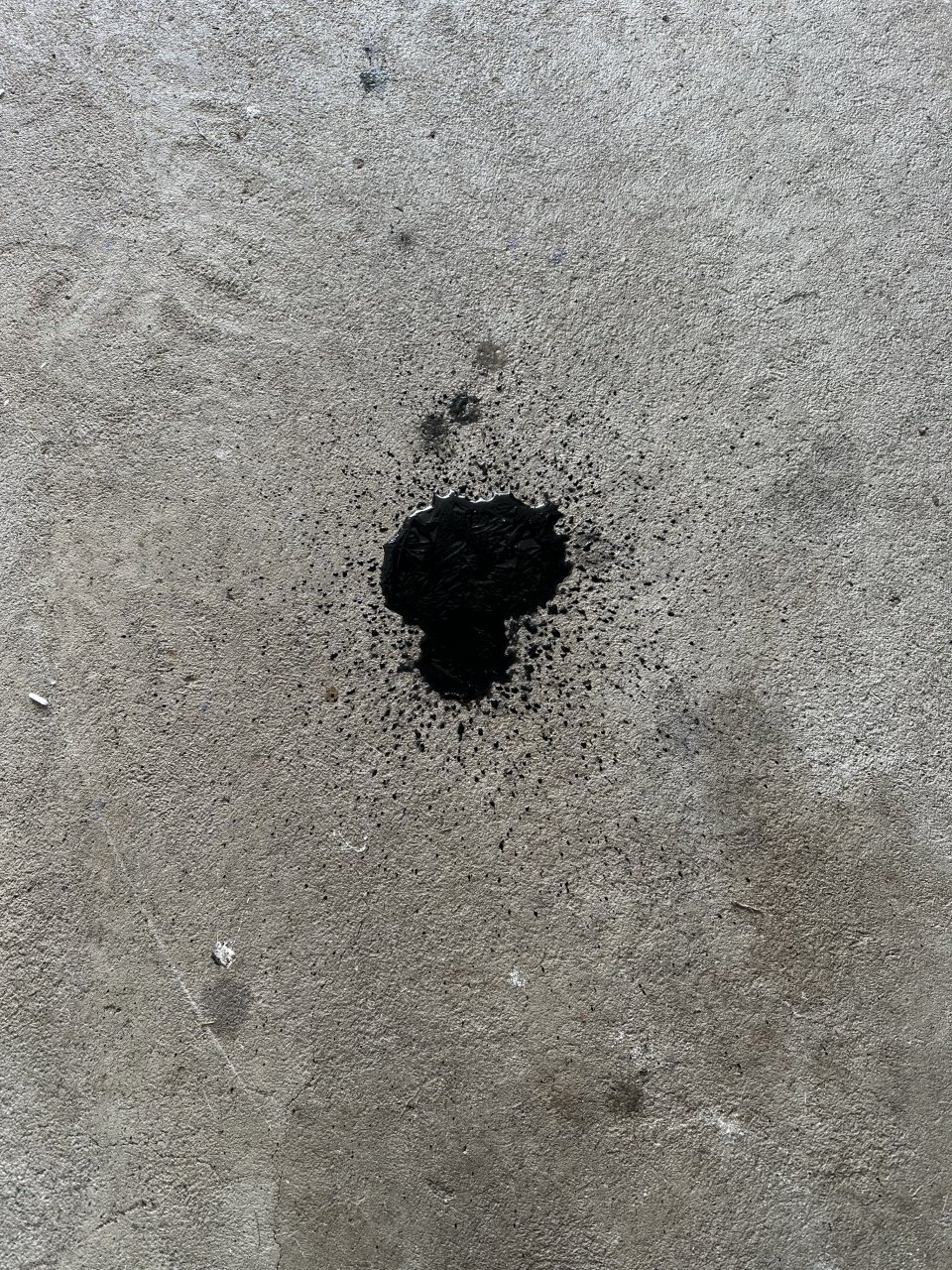

    I better get it back in the shop and have a little look - it’s way too black and sooty to be engine oil.
    I’m not set up well here for lifting it to get under and investigate.

    Just an opinion and certainly not worth not taking it in but I think it’s soot out of the exhaust from condensation. Today in the snow before Justin come with the tractor my flatbed was dripping stuff out onto the snow. Naturally my heart sunk but after further investigation that’s all it was. From the pic that’s certainly what it looks like to me

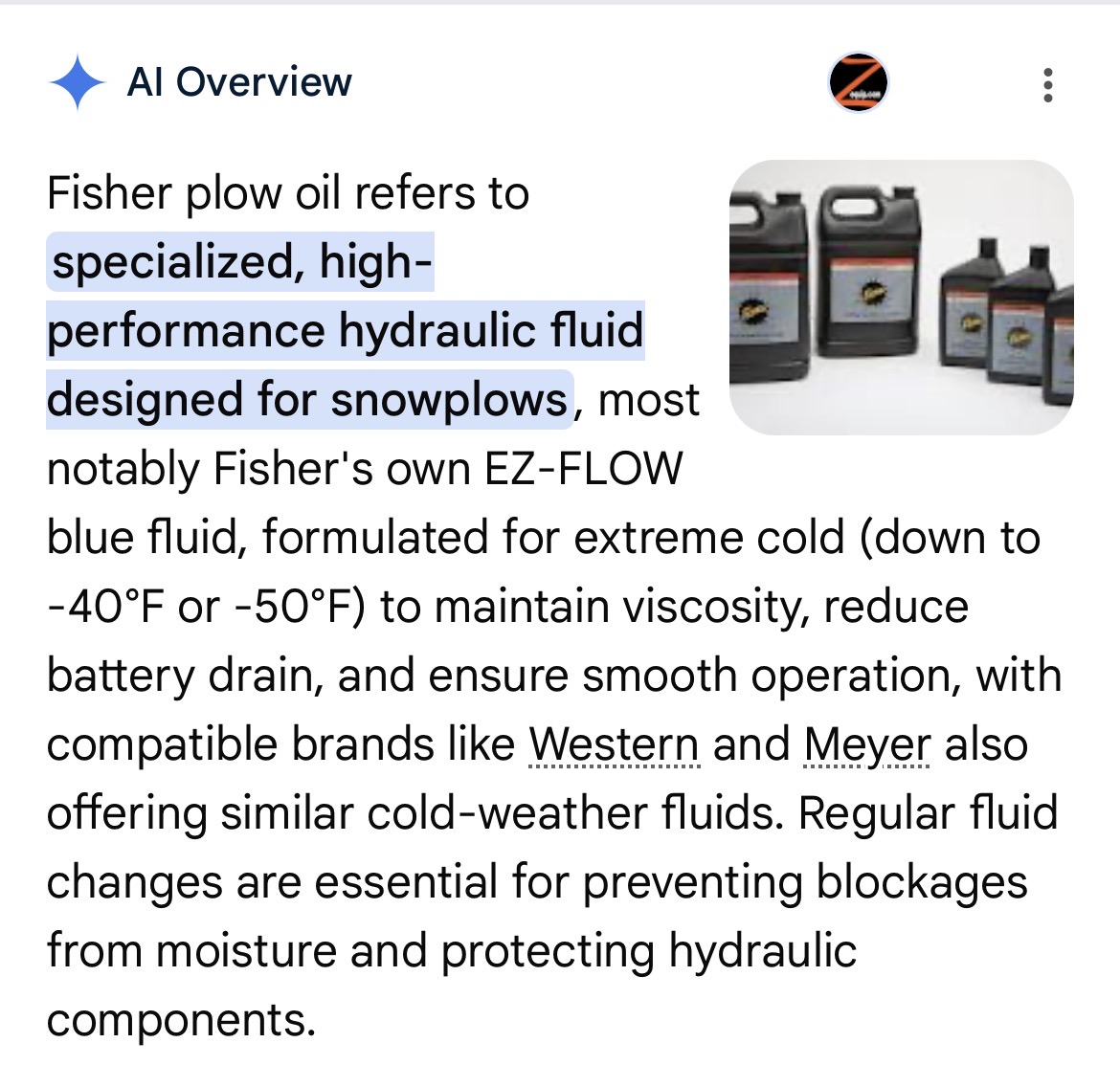

    At first opportunity (Annual, maintenance, busted hose or bad pump replaced and system flush) refill with Dexron II (or whatever it is now).
    We used that in forklifts; operating in freezers, inside with an insulated charging room. Truck stayed out in the aisle, room for the chargers.
    Didn't bring out unless had to, as condensation played hell with EV1/SCR controls. You will be using in cold weather.
    If you are concerned, go price you some "Aircraft hydraulic fluid and then decide...

    My 5 point slow will leave a puddle of sooty water from the drain hole at the back of the resonator and from the stock muffler (when it was on there) and it looks a lot like that at times when it's really cold out.

    A busted hose put me through my good stuff, low temp hydraulic fluid. Really seeing the difference with the “stuff that was lying around”. Will be doubling my strategic reserves in the future upon it’s replenishment ;)
    Added…… will have to check to see what exactly the sell us in those bottles. Will test and adjust as needed, thanks for the tip
