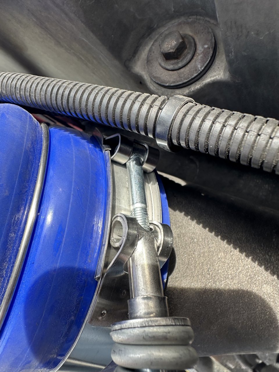

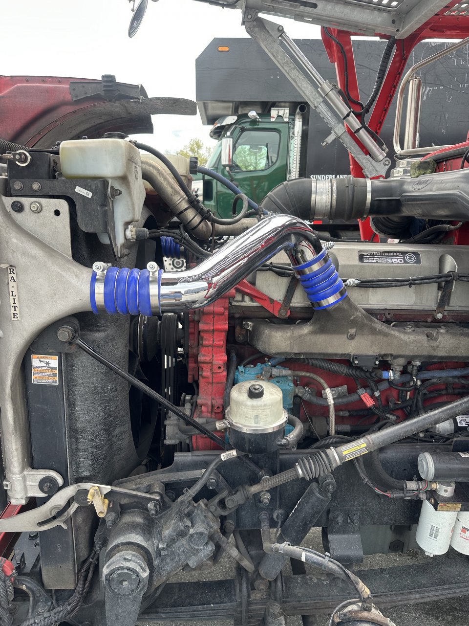

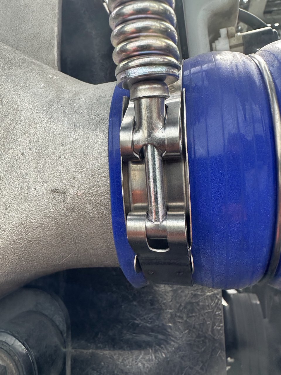

    I learned something about the wrong size clamps last summer on the side of the road. I put 4 new hoses and all clamps on one day last summer thinking I was doing a great job. I didn’t pay close attention to the threads as I assumed my parts store gave me the correct size clamps. It pulled fine the first 300 miles until I started in the hills. After closer inspection a few of the clamps had no thread showing resulting in a not so tight seal. I fortunately carry a box full of old clamps and put them on until I got to a place with the correct size clamps. New hoses and clamps is a relatively cheap fix and i carried an old hose and several clamps as spares. IMG_4522.jpeg IMG_4523.jpeg IMG_4526.jpeg
