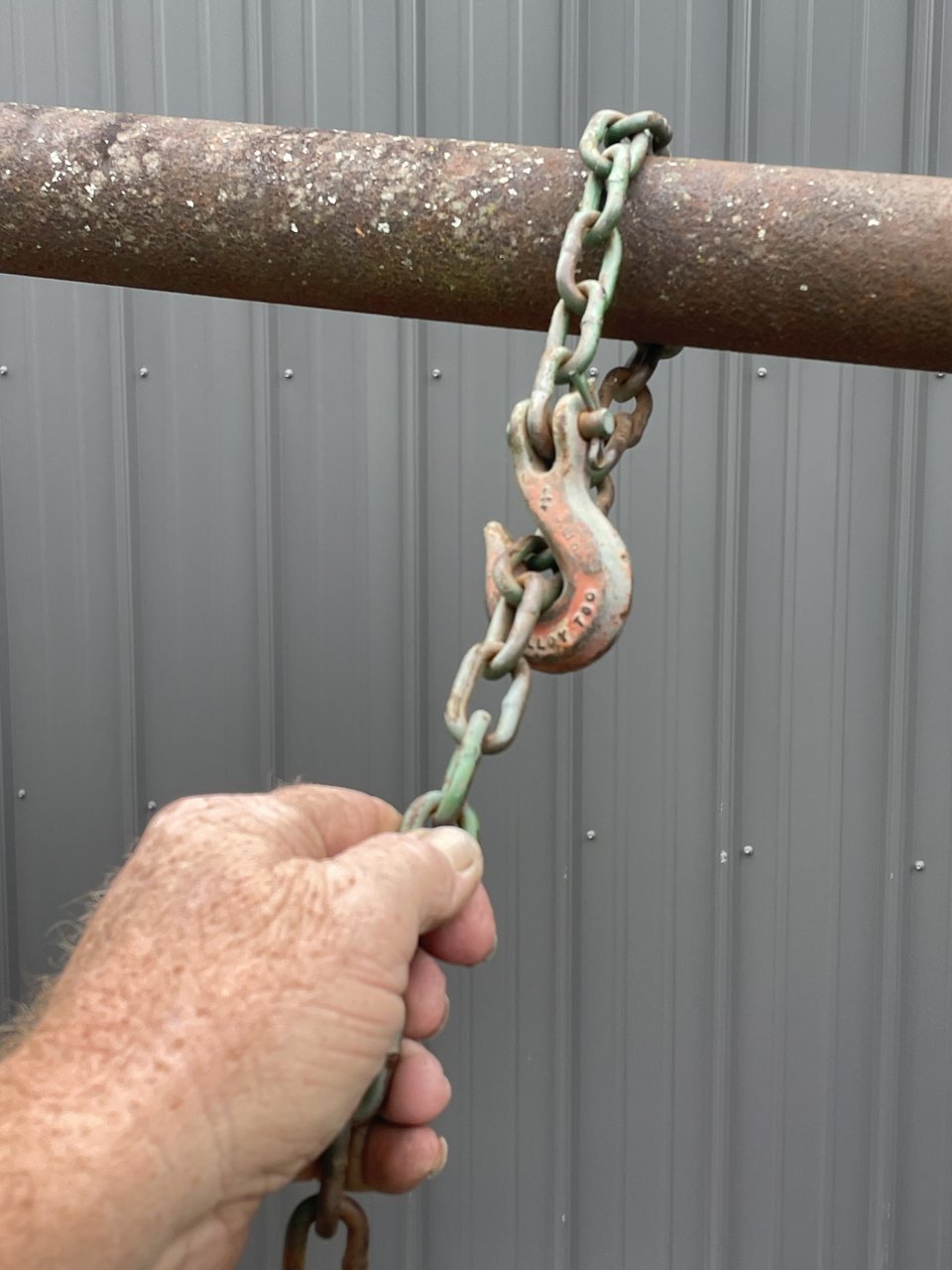

    You can get a 1/2 link instead of a full link, makes a world of difference…

    What do you mean by half link?

    1/2 link is when you wrap the chain around the pocket/spool on the side rail and hook it to a link, 1/2 link is going to the next link instead of using the snap binder for another link.

    Make your anchor point like this, every link becomes a 1/2 link then. If your snap binder is too tight and you can’t break it over, just move the hook back towards the anchor point 1 link which is actually a 1/2 link. Or if it’s to loose move the hook 1 link out, makes a world of difference….
