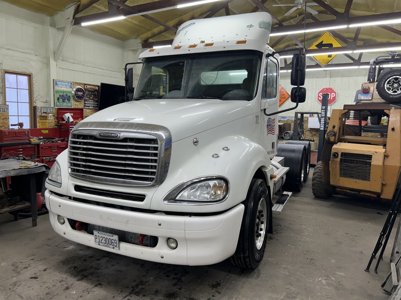

    Mines 1995 S60, hates cold starts.
    ‘block’ heater is a loop element directly behind the water pump in a flat ‘S’ shaped manifold.
    3-4 hours plugged in (2000w element?) Will have the coolant temp at 60 degrees.
    Then the main concern is battery health to crank, and diesel additive to prevent gelling until warm fuel returns to the tanks/system.
    I am spoiled in the regards to having it in a covered uninsulated shop, but plugged to shore power that has a battery tender. If the batteries are down, the generator will usually still fire - and then charge batteries enough to fire the truck up.
    Long story short, just 3-4 hours on the block heater before firing it up is fine - but like @Oxbow mentioned, watch your connections and cords - I about burned my #### to the ground a couple of years ago from a loose connection.
