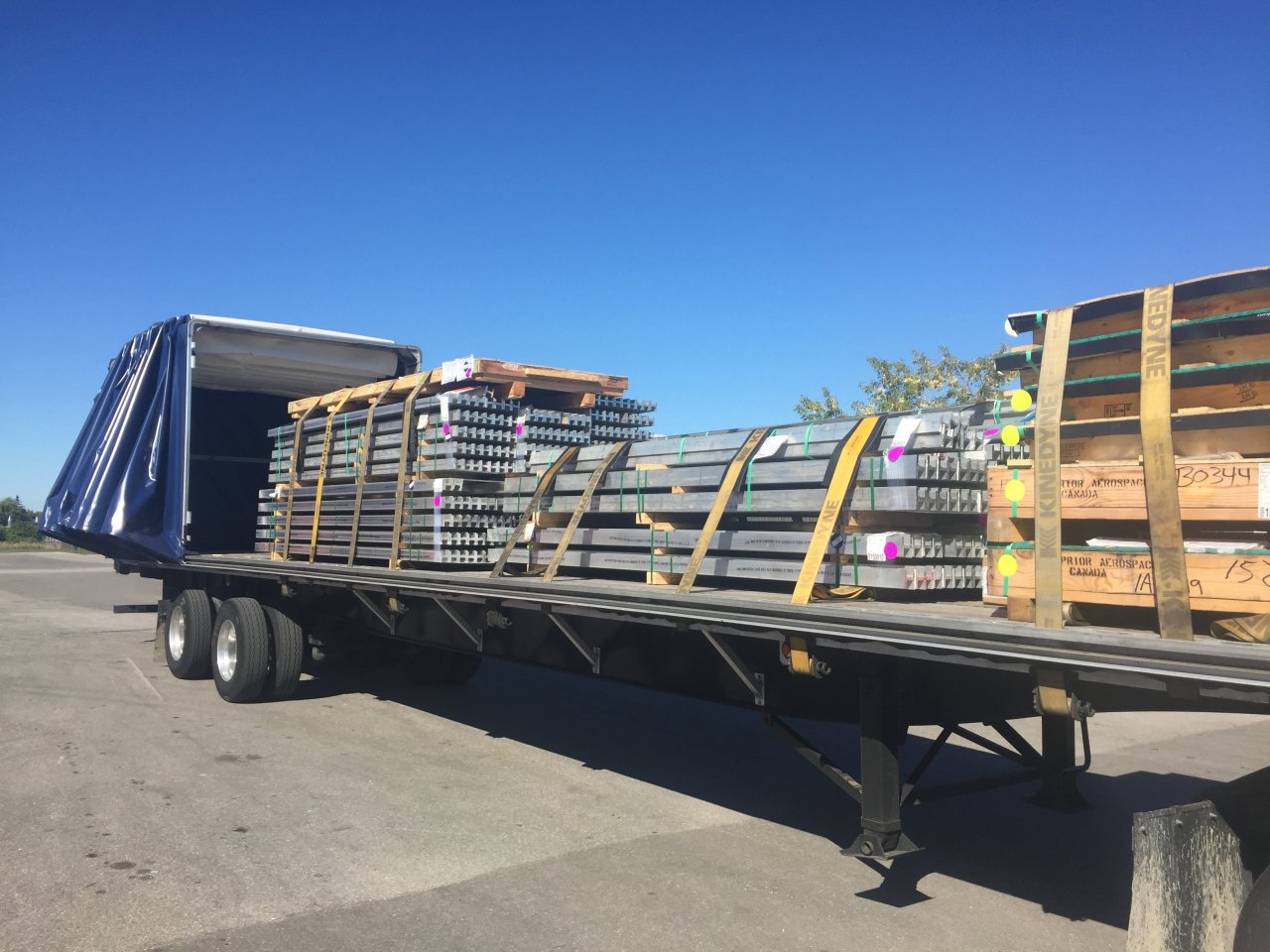

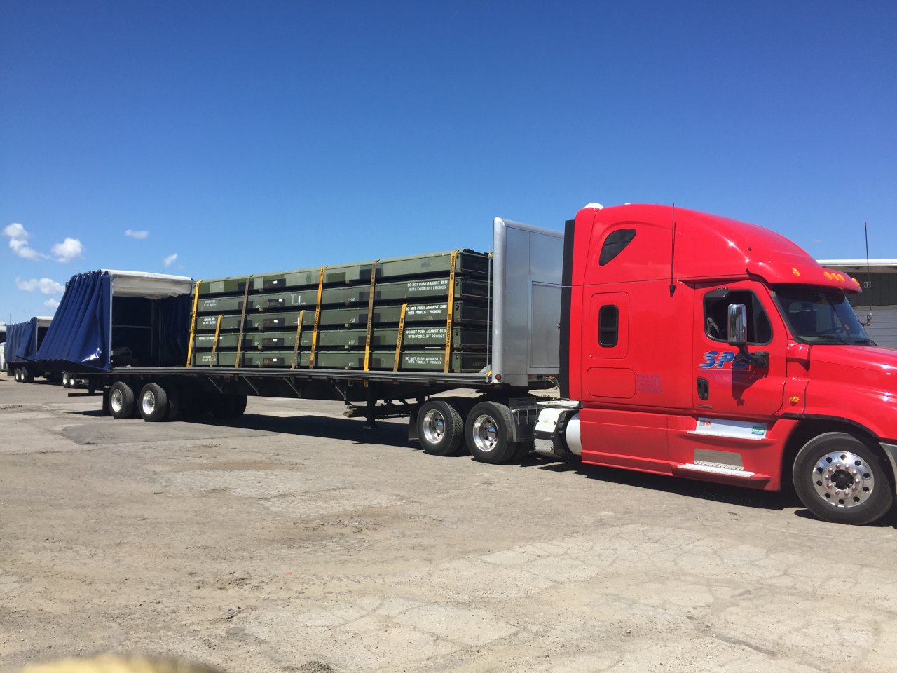

    Your photos show that you indeed secured those loads according to those regs, I suspect as a result of being conscientious about it. :)
    The loads over 6 foot and 3 tiers, you have secured with a gut wrap, the one's that might appear to be close to 6 foot, aren't over 2 tiers. :)
    You have a bulkhead structure, so the penalty strap isn't needed (although I tend to put them on anyway- my OCD :) ) and so depending on the weight, those look like properly secured loads. I suspect your training and your erring on the side of caution is why it's done the way I would have done them.
    In addition, most of those layers in the photos, have dunnage between layers, which assists friction, whereas the metal structures that she loaded only had dunnage on the lower levels, thereby not having sufficient friction between layers to hold the load in place.
    Yours are properly secured, hers were not. :)

    That header on the one trailer is just a conestoga nose, it has no structural strength.
    merv85, stwik, Tb0n3 and 1 other person Thank this.

    Yeah, but it's one more layer of aluminum that is harder than the flimsy aluminum of the cab. Whatever can slow it down so the next holds better, is better. I would have put another strap on, but that's me. :)
    Depending on the maker, by the way, that bulkhead is rated and DOT approved, so your statement may not be accurate.
    Aero for instance, has two DOT rated and one non-DOT rated bulkheads. Whether it stops something or not, isn't the point in that regard but if it's rated for the required bulkhead specifications that are DOT approved, it qualifies as a structural bulkhead contrary to opinion. I don't consider a van front wall to be sufficient either, but it apparently is DOT rated to qualify as one.
    I guess we need kylefitzy to let us know the model and make so we can look it up to be sure. :)

    It was a quickdraw brand. None of that really matters though. If the load is not in direct contact with the headboard, the headboard is ineffective, and an additional strap or chain is required.
    merv85 and CAXPT Thank this.

    Well, depending on the structure, it's best when in contact, I agree, but there's alwas some distance involved, so not sure, but I guess that means you'll be putting an extra strap on from now on then, eh? :)
    By the way, just checked your manufacturer, and indeed, you do have a DOT approved headboard, so that qualifies it as structural.
