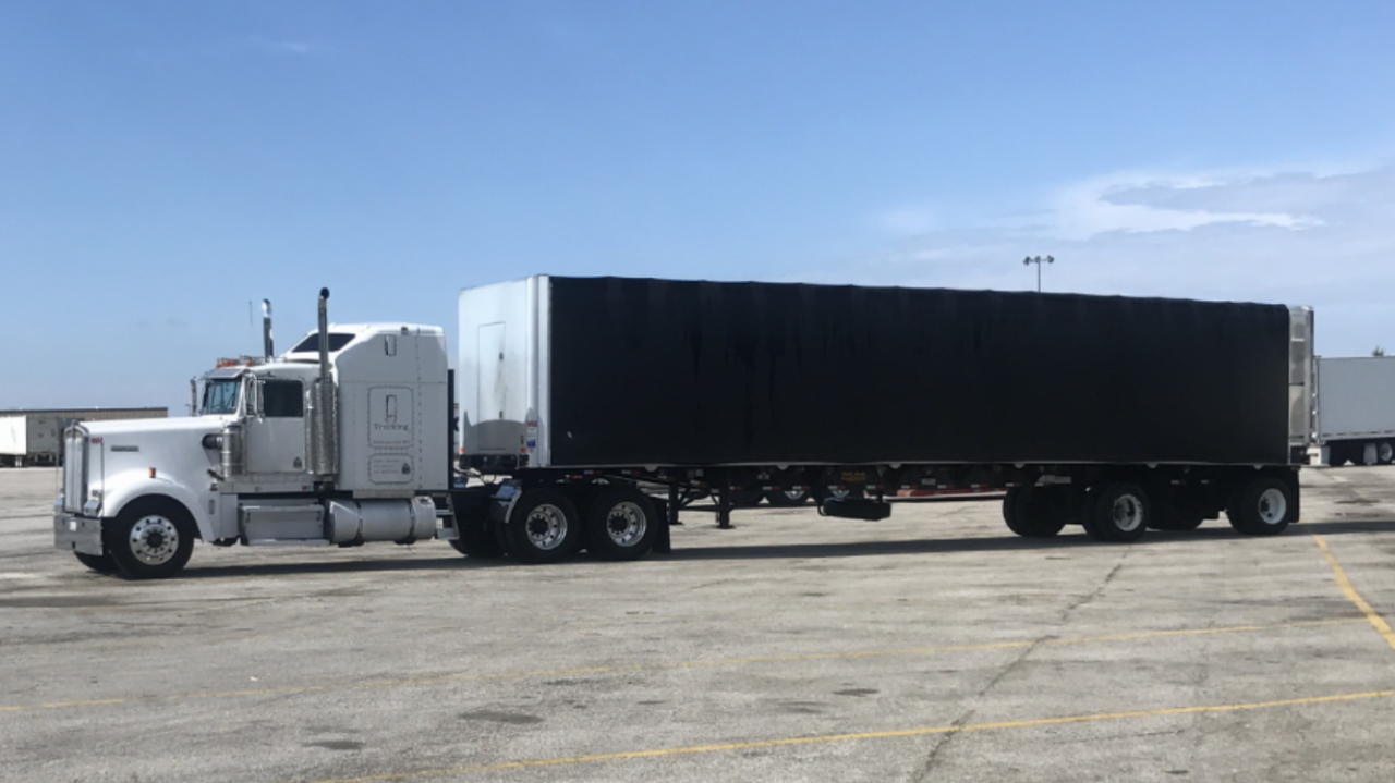

    E714B41C-AB83-4126-8CB0-A516951FB250.png My setup is good for the work I do. 95% of what I haul needs tarped. OS/OW loads are out the window with them. The way my rails are mounted the pockets are now null and void as anchor points.... chain and strap. The rubber seal at the bottom created a fit issue with my 4” straps, but a few minutes of alteration with a sledge hammer and that is no longer a problem. Unless your load is close to the edge, the ability to load, close the tarp, and then get inside and secure the load in the dry is a plus. Keep the guide rails clean, and don’t use any oil or grease on them, mine are guaranteed as long as I own it. After paying close attention to it and checking my numbers, I did notice a drop in mpg. But still..... if I keep my rpm’s down while cruising, 5 to 5.25 is not bad with the power plant I’m using.
