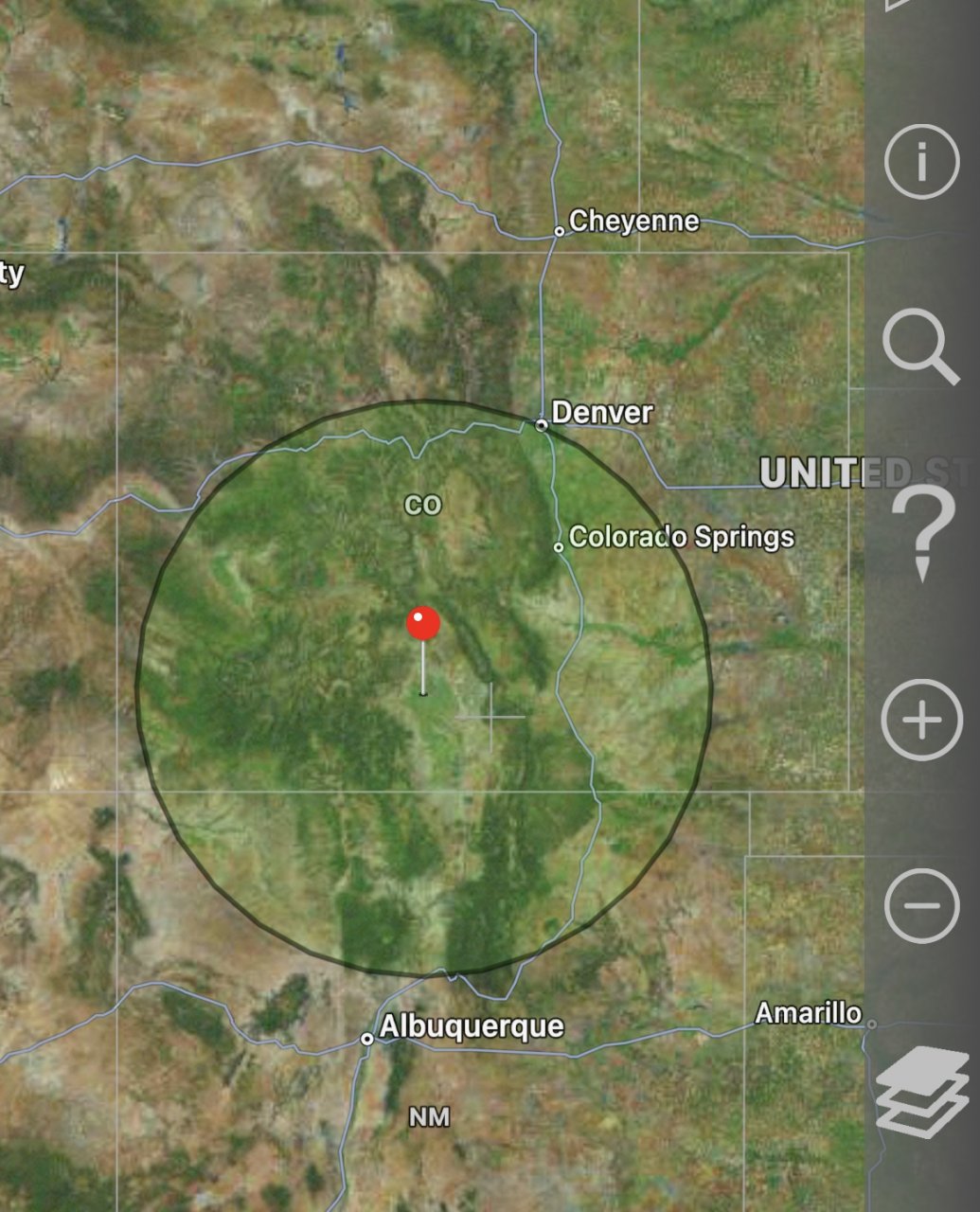

    I’m not sure exactly where you’re loading but here’s your ag radius from the town of Center. You won’t be starting your log until you’re almost to Limon. Then it’s roughly 7 hours of driving to Topeka.
    Load, run up toward Limon, start your log book and drive to Topeka, take your break, drive back. Then when you hit the radius coming back by the time you drive to Center and load you’ll be able to catch a nap for a couple hours and time it so that you’re back up toward Limon right when you hit the 10 hour mark to reset your clock. Then you just go on duty and drive to Topeka again. Take a 10 on the east end after you’re empty and then drive home.

    Still 50 or 60 miles on the log on the way home for him after Denver, but yes, it could work pretty easy.

    He’d have to log all the way home from Topeka. When he leaves home he will have to log a little bit and then his off duty time will pause his 14 so he can still get all the way to Topeka.
