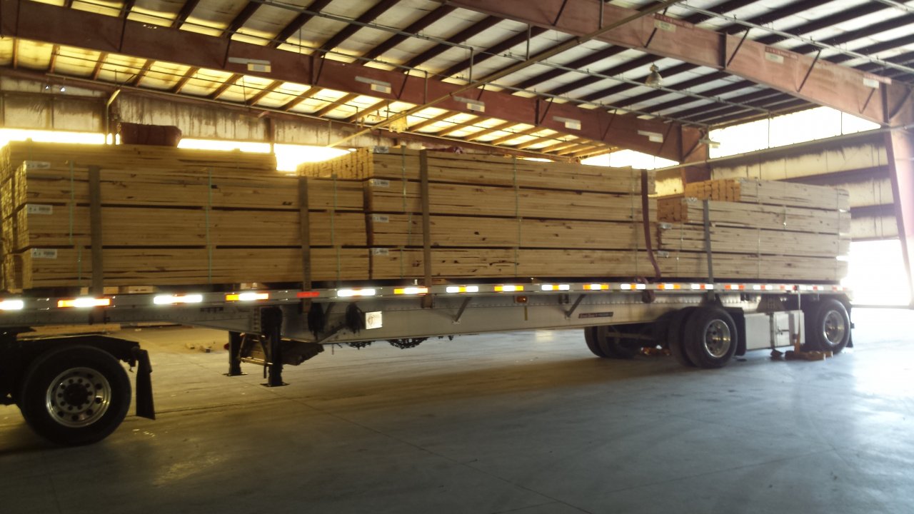

    I took this load of dressed lumber from VA to OH. I was fully aware that dressed lumber requires straps over the first couple layers and then straps over the top. However I've ran into a couple places that just throw it on you 4 high and I see everyone just throwing straps over the top. So like an idiot I've done a couple loads like that. This was the last time I'll ever do that.
    First picture shows the whole load. The forklift driver is moving the 2 ten foot bundles from the back that he swore needed to be back there but after weighing and proving they didn't and then threatening to make them unload the whole thing he finally did what I said.

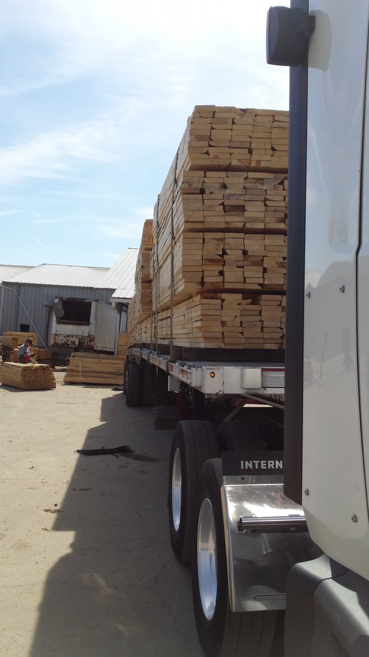

    Second and third pictures show the load shift after I swerved to avoid an idiot 4 wheeler.
    The load was approximately 6 feet tall. Thus I was technically legal but legal wasn't enough in this case. 20160321_143151.jpg 20160322_120114.jpg 20160322_120128.jpg

    Swerved?

    Yep. He slammed on his brakes to hit the off ramp that he almost missed.

    Doesn't look like it shifted that bad. Next time gut strap it. I had ask loaders to take a few off so I can throw a strap in. Usually anything over 2 tier high

    The middle tier moved to the rub rail. Yep from now on its stack them two to three high depending on how high we're going, a couple straps and then the rest. No reason not to. I have 15 4 inch winches now so I had plenty to do it.
