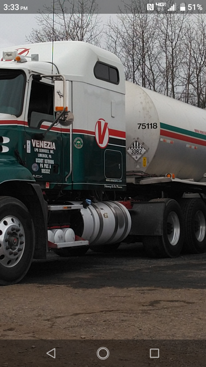

    Is that why there's 3 cans in between the steps? Screenshot_20210306-153339.png

    The wet tank on a Pinnacle was the black tank directly under the drivers side floorboard, sitting longways above the battery box.
    Sounds more like a bad air governor...and unless you like getting dirty, it needs a shop to replace it.
