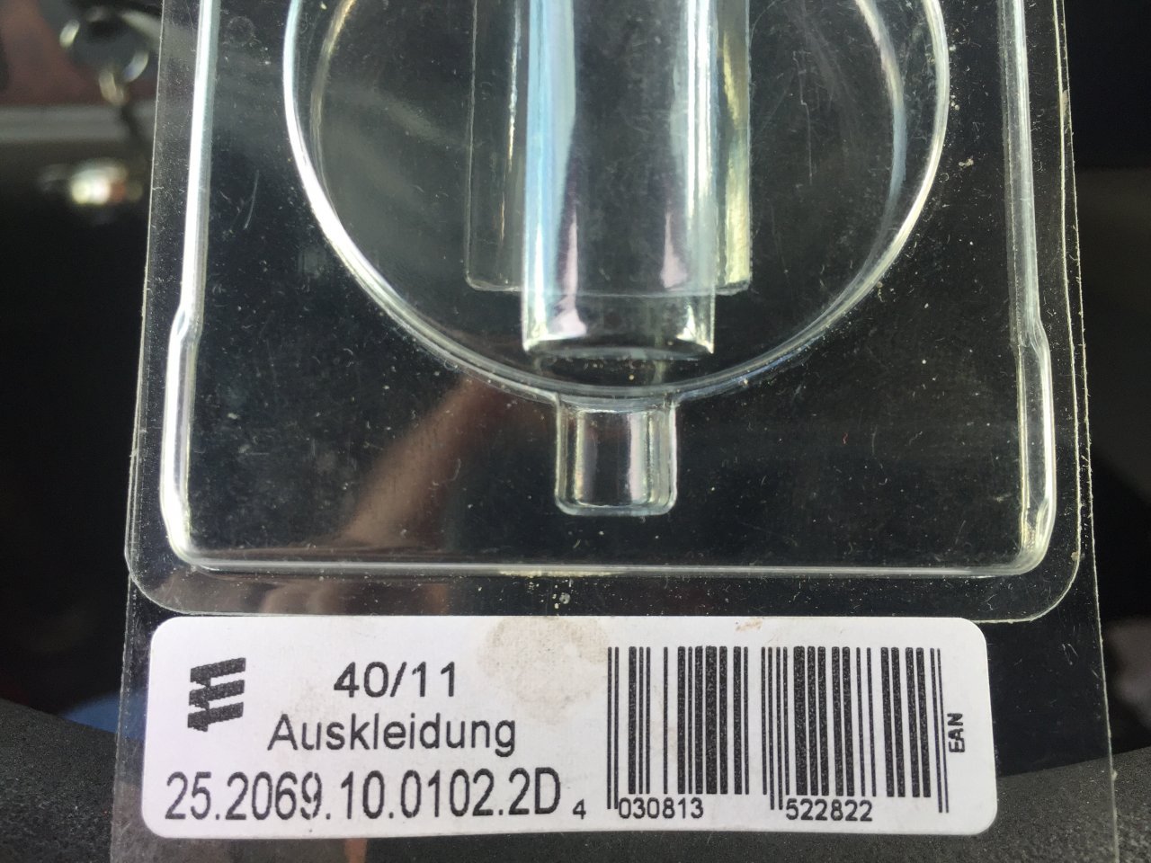

Take top cover off. Using above tool on left, remove filter nut thingy, and replace with new filter, using tool on right.
Wait - when you turn it on you're getting all the sounds you normally hear, but maybe white smoke, then it shuts down? -
Use a little metal pick with a hook to remove old filter mesh. You'll destroy it getting it out.

Where can I get such tool?
