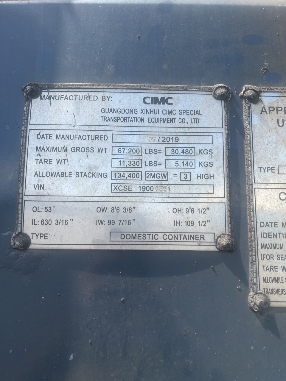

    Says the height in the picture. OH: 9’6 1/2
    OH is outside height.
    with your measurements it’s under 13’6 for sure.

    Not to split hairs,but OH is overall height.

    Thanks everyone. First time hauling a container so I was extra cautious.

    High cube containers on Chassis were usually 13’5-13’6, (depending on fifth wheel height, we had risers for tank work.
    regular containers were 13’ ish on chassis
    wis bang and Oxbow Thank this.
