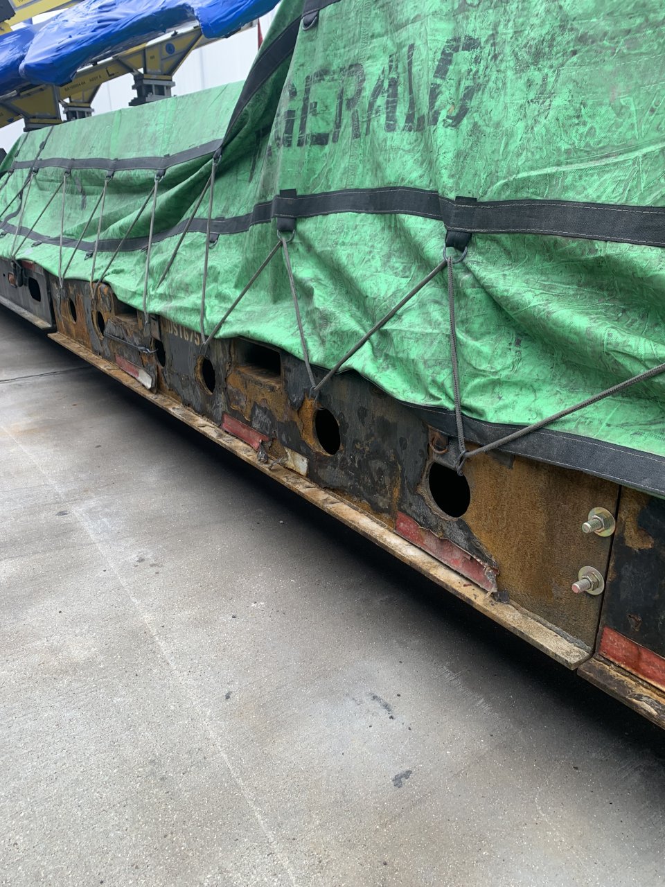

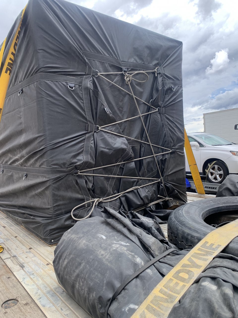

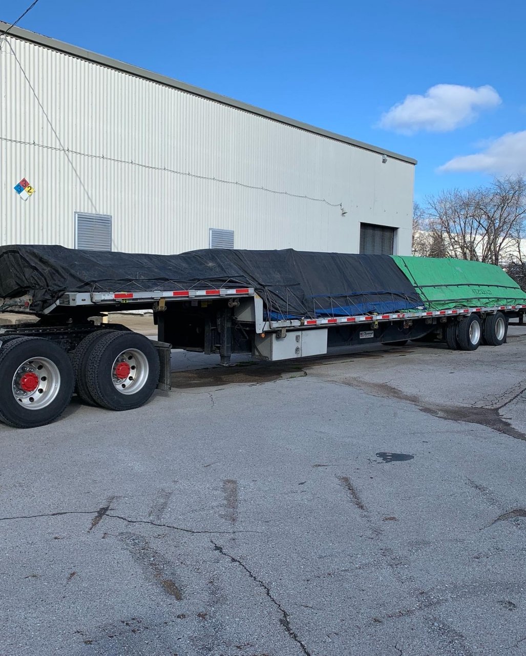

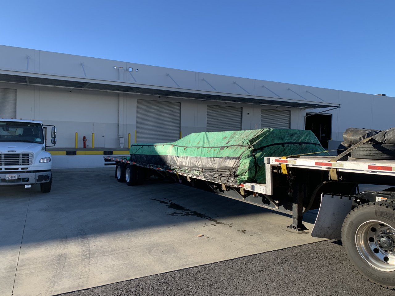

    3/8 bungee rope is the best way to tarp if your trailer has hooks. Of course I work with a bunch of knuckle draggers that just break them off. I carry a coffee can full of old bungee hooks. The only knot I use is a half hitch. IMG_6496.jpeg IMG_6405.jpeg IMG_5301.jpeg IMG_2788.jpeg 3C0220BC-788A-4AEA-9C30-A72BF97CBDFA.jpeg
