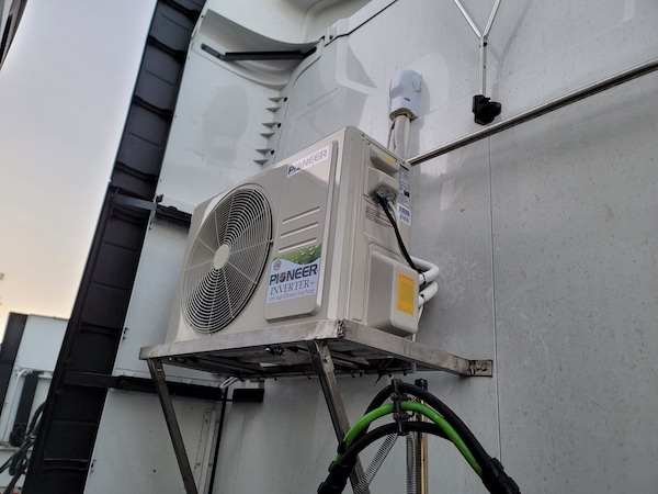

    Same, but with solar. Under less than ideal sunlight or at night, might still idle an hour or two here or there. Ultra efficient mini split sells for under $1000 and isn't rocket surgery to install.

    Not a bad set up. It is clean and works pretty good I bet. I would do that if I went back to a running apu

    Same thought I was thinking instead of motor. My next truck I will do something similar with some better batteries so can run for a day or night without starting truck.

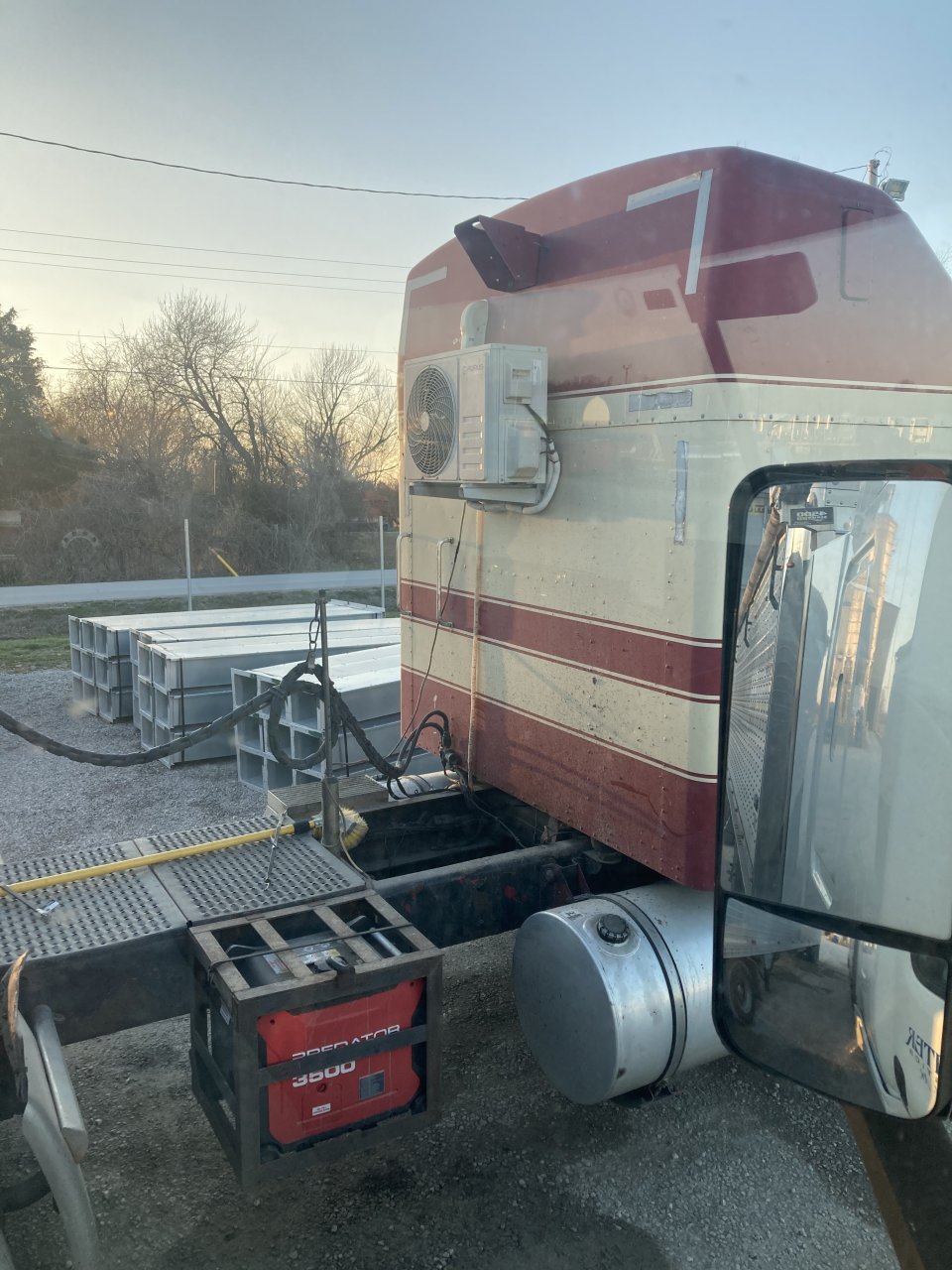

    I Use to run a honda and hated it.. Always had to make sure you parked at a truck stop so you can get gas. Worst part was walking in pouring rain to get gas from the back of the lot. When my carrier compressor goes im just gonna use that generator from the carrier and run a mini split works WAY better lol

    I got a Predator 9500 inverter for home backup power. It's a really nice genset. How is that 3500 holding up on the truck?
