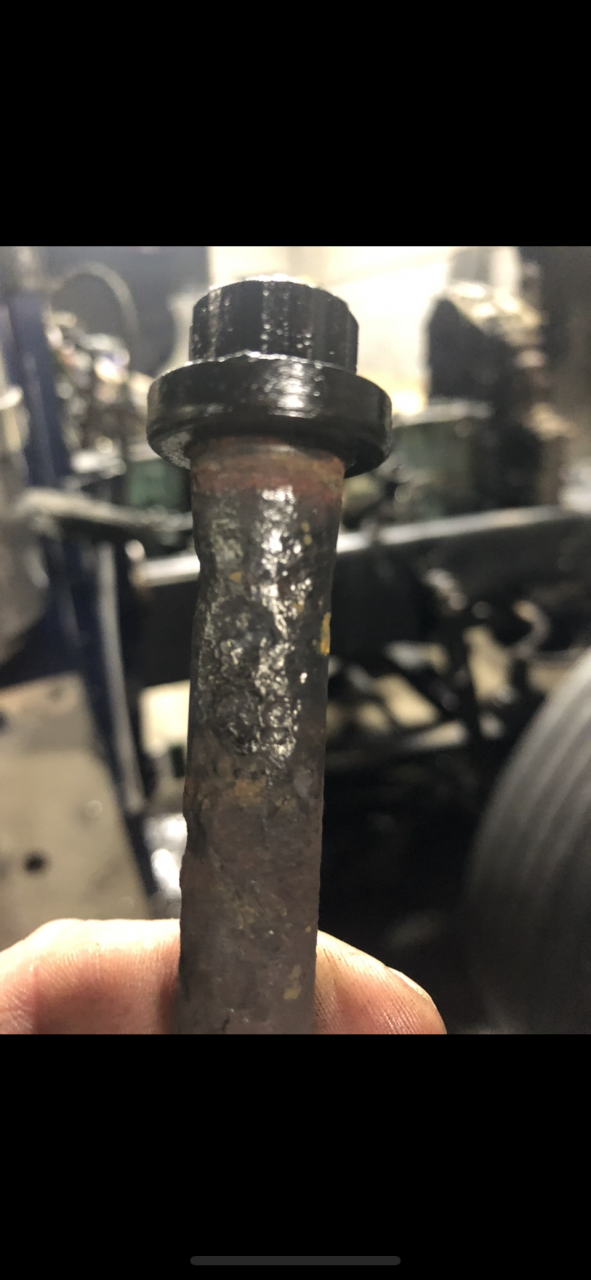

    FAF90689-E0CF-4F87-9B9B-32135DA66591.png Ok, here’s what I was lookin for. This came out of mine after 1.4 million and 12 years. Coolant must have been leaking into it for a long time. Good case for the bigger bolts. Even though the threads are obviously the same.

  6. bruce25
    bruce25 Light Load Member
    150
    90
    Apr 16, 2014
    That looks rough these bolts I bought got higher tensile strength then PAI 1000mpa vs 1200mpa this was accidental find I thought they were all the same.

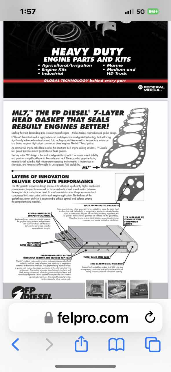

    23589952-6B73-446E-808C-113F3E69D0A5.png I wonder if the one I used is considered an upgraded type.

  11. bruce25
    150
    90
    Apr 16, 2014
    That's interesting I will check the gasket I ordered but one thing that came in different was exhaust manifold gaskets. Usually they are just thin steel but this time they are steel with graphite on both sides much thicker like the head gasket. Seems to me there were some upgrading going on in past few years? Give me few mins I will take a pic of the exhaust seals
    New one vs old one I have always worked with old style and new one in my opinion are much better should provide a better seal less chance of leaks.
    Only thing Detroit kits are missing now are thicker turbo mounting gasket that cat uses
