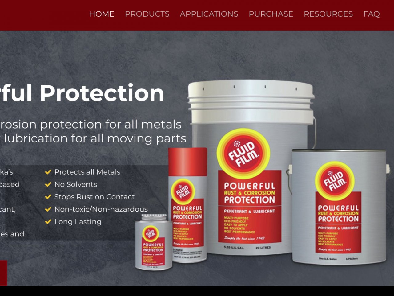

    4CB26F74-64A8-4868-AAB3-B12ECD8F6D44.jpeg I use this for some of my posts and all of my slider channels. It is the best lube I have found. It is pricey so I buy it in the paint can style in a gallon bucket for big jobs. I keep a spray can version in the truck for temporary sliding issues. It allows decks to slide or lower much better than slip plate does on my rig. For my posts that I physically come in contact with I still slip plate because the Fluid Film does not dry and comes off on you if you come in contact with it.

    Banker where can I purchase? Online or specific shop?
  7. Banker
    Banker Road Train Member
    4,497
    14,480
    Aug 19, 2012
    Sometimes Amazon is the cheapest other times they aren’t. The last time I just googled fluid film and bought a case of spray cans at a good price, but I am not sure who the vendor was.
    Kozakvod Thanks this.
  8. VTech
    VTech Bobtail Member
    26
    40
    Oct 8, 2015
    Lowes and Advance auto around my house sells the spray cans. But it's definitely cheaper on Amazon.

    I get it on eBay.

    Nope. The shafts extend (raise) just fine, and without weight, they return normally. They had been NOT coming down with weight on them. I found the Fluid Film at Lowe's last night, I was already loaded today so I sprayed everything down after getting unloaded. I'll throw my old truck on it tomorrow and see if that solved my problem or not. Absolutely sliding more smooth now, hopefully #18 was just binding up in the guide rails.
