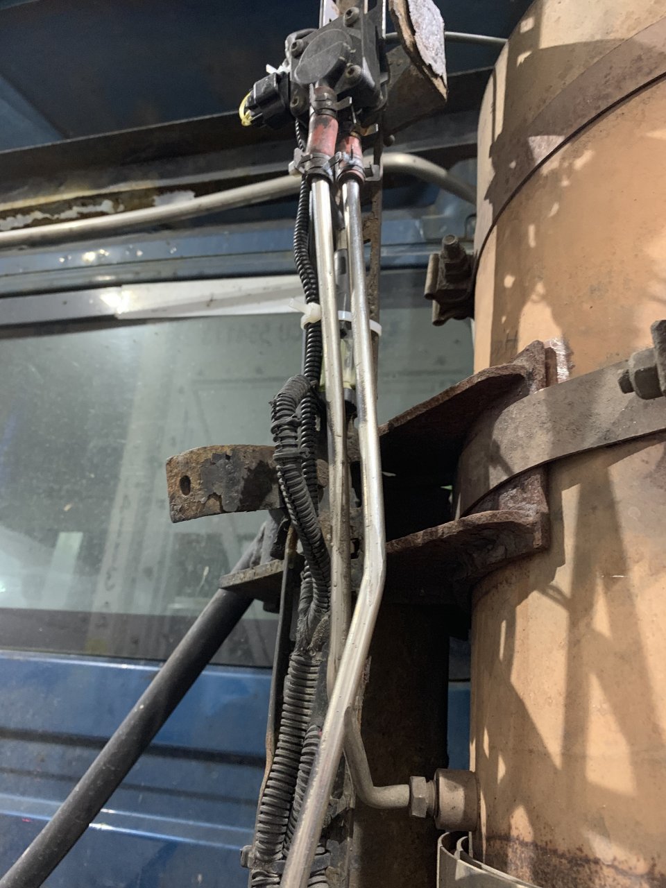

    Hey I’m still having the same issues and I didn’t want to just throw parts at it. When your triangle was on was in coming on during heavy loads are it stayed on? Here’s a picture of mines but it just comes on during heavy hauling mainly.

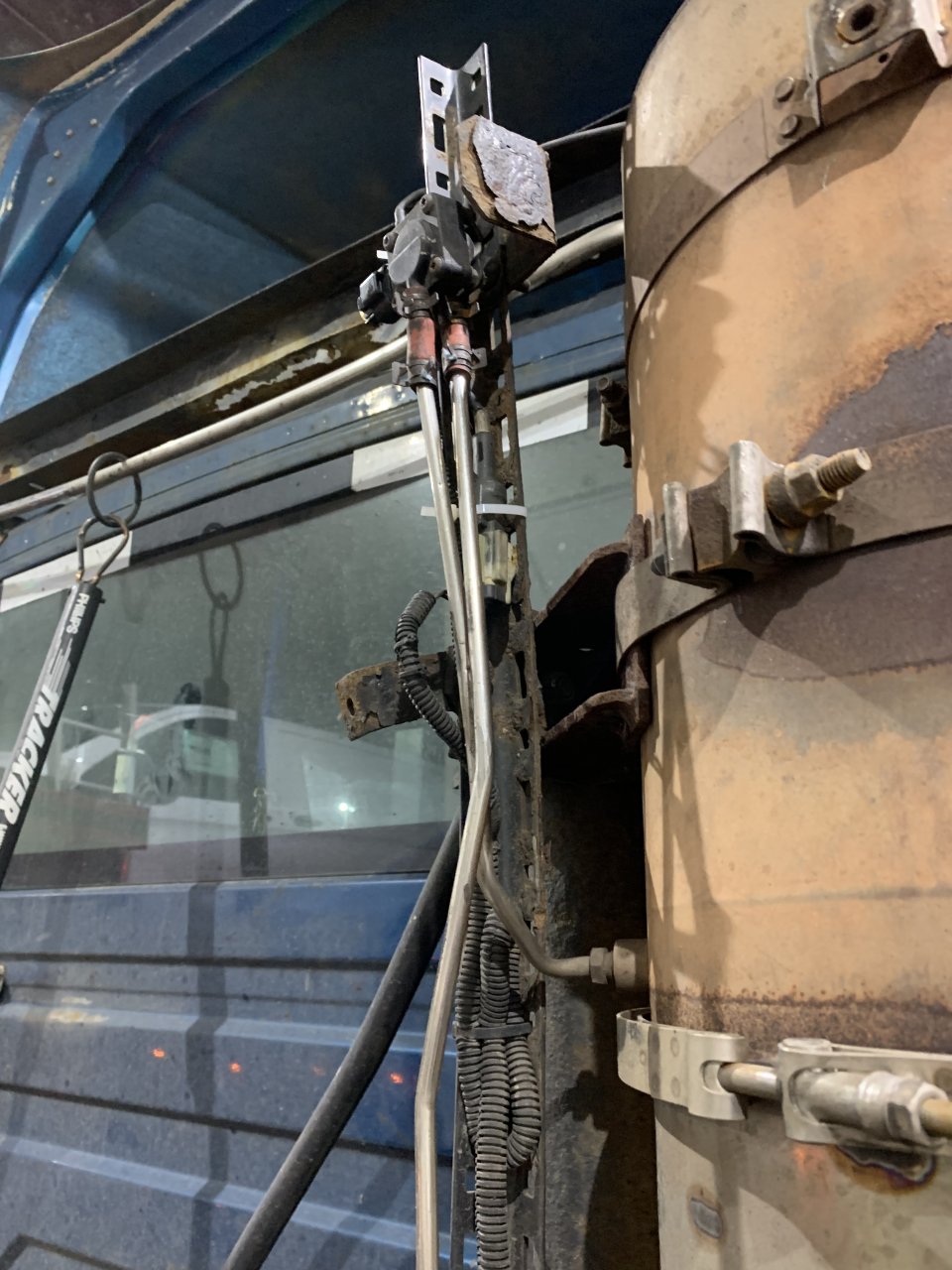

    Also can anyone confirm if these are on correctly. Nothing was cracked or broken when I checked today so I thought that maybe I could also have them on the wrong tubes...

    Most of those sensors have "HI" engraved in the plastic on one side. This is the high pressure port, or where the inlet tube should go. On yours, the inlet tube is the bottom, or long tube.
