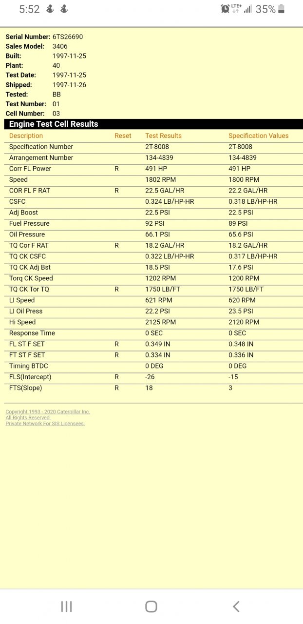

    It was 475 and boost I want to say was bout 35

    I have a 3406E and put a 550 brakesaver file in it. It already had 58’s in it. I upgraded the turbo with a BW Stage 1. I can get 43-45 of boost BUT, I don’t hold it there long cause it creates Hot intake heat. If I was in your shoes, 40 psi would be about right for what you have. I wouldn’t doubt it either if Cat dump the low nox 550 file in it.

    40psi must have a BW non wastegated turbo.
    get someone else to flash a pre clean power 550 file
