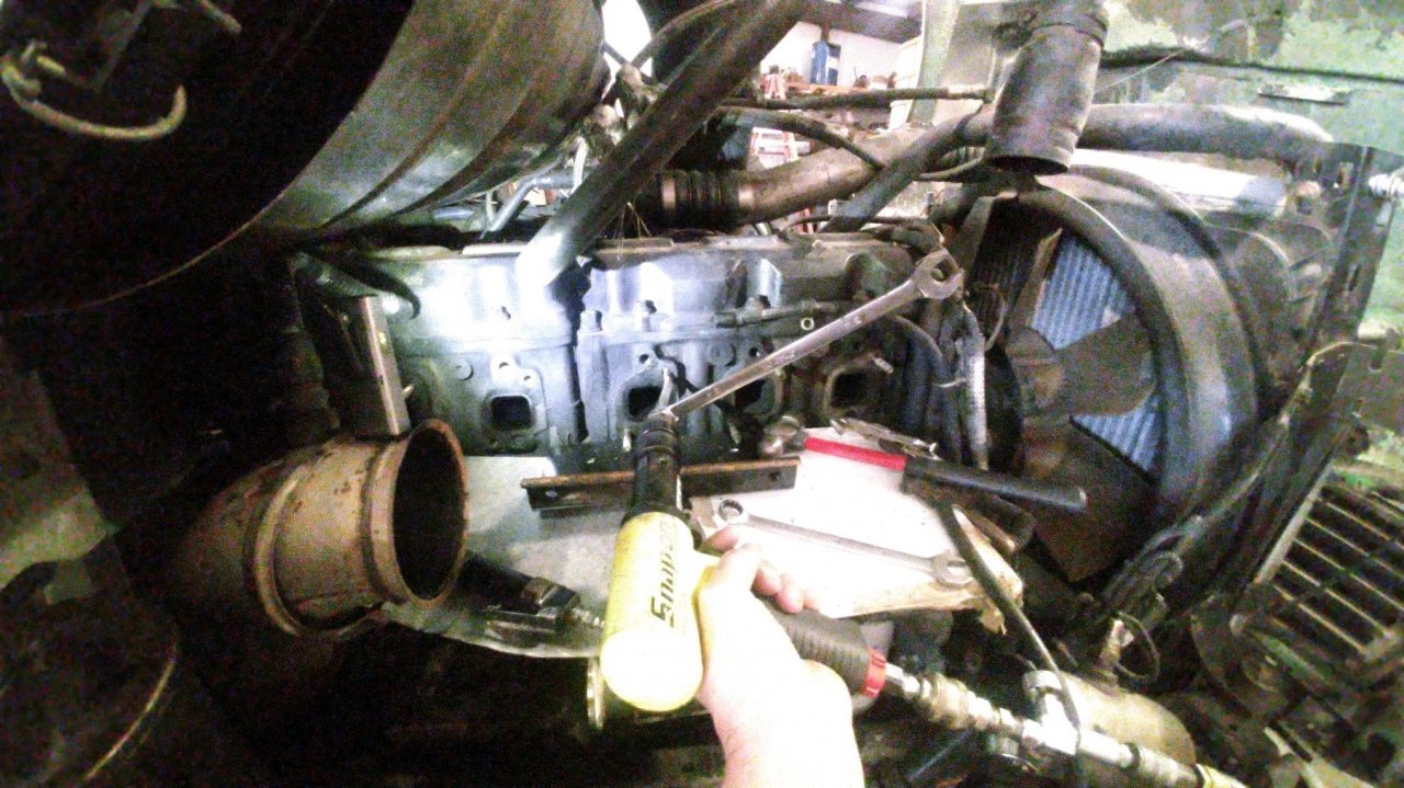

    I have a couple studs on the manifold that are broken. I was wondering what all you guys replace when doing it. I’m not sure if a manifold is worth doing from what I read the benefits are negligible, but I’m not against doing one since I will have it off. And if you guys recommend a stud removal tool let me know as well.

    If the manifold gasket area is OK I have never replaced the manifold. All the studs nuts and spacers in most cases. I have a stud removal tool. However I usually just lock two nuts together and see if it will turn. If not maybe spot weld the end of the stud and nut. Then shock it, beat on the end of the stud with a hammer. Lots of little tricks and tools. output_image1715651712736 (1).jpg This is a Mack with stainless studs. That is an air hammer with a tool for a wrench in order to hammer and try to turn at the same time. It is connected to 1/2" square key stock that is welded to the broken stud. It was straight in the beginning. Never got that one to turn. Had to drill it out with carbide bits. Probably lots of info on this subject in the search block.
