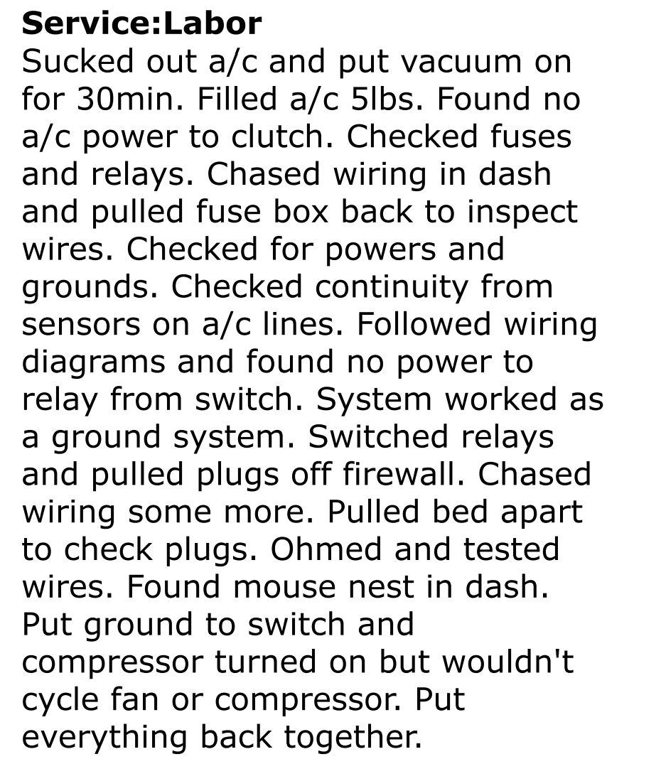

    Hello All,
    Returned from vacation hoping to have AC in my Pete but the electrical issue I've been dealing with has caused the shop I use to throw in the towel. They worked on it for 4 days testing and chasing wires looking for shorts. Thankfully the shop owner is a very nice guy (And I always pay my bills) and he only charged my the labor to cover his guys labor so he could break even.
    I'm including a screen shot of the work order.
    What I'm looking for is a Pete 379 guy that is really good with electrical. If anyone has names, location and contact info I would appreciate it.

    There is no power signal from the switch to the relays. Pete used a ground signal. You can follow it across the top of the firewall.
    My memory may be off, but
    The switch send a ground to the thermal switch, then low pressure switch, then from low pressure it goes to the high pressure switch, and then to the A/C clutch relay, where it grounds the relay.
    The relay then sends the signal to the A/C clutch with a different wire.
