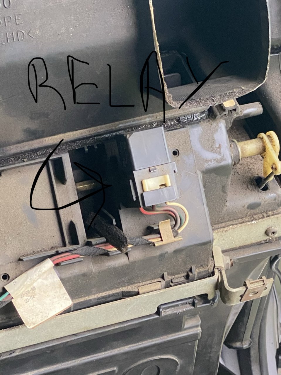

    My Blower motor went out, so I thought. I went down there and found a loose pin on the jumper harness. I Fixed that.
    my a/c compressor is not getting power, so it won’t engage. I tested for power at the plug, truck side. I have put 12v power direct to the compressor and it will engage.

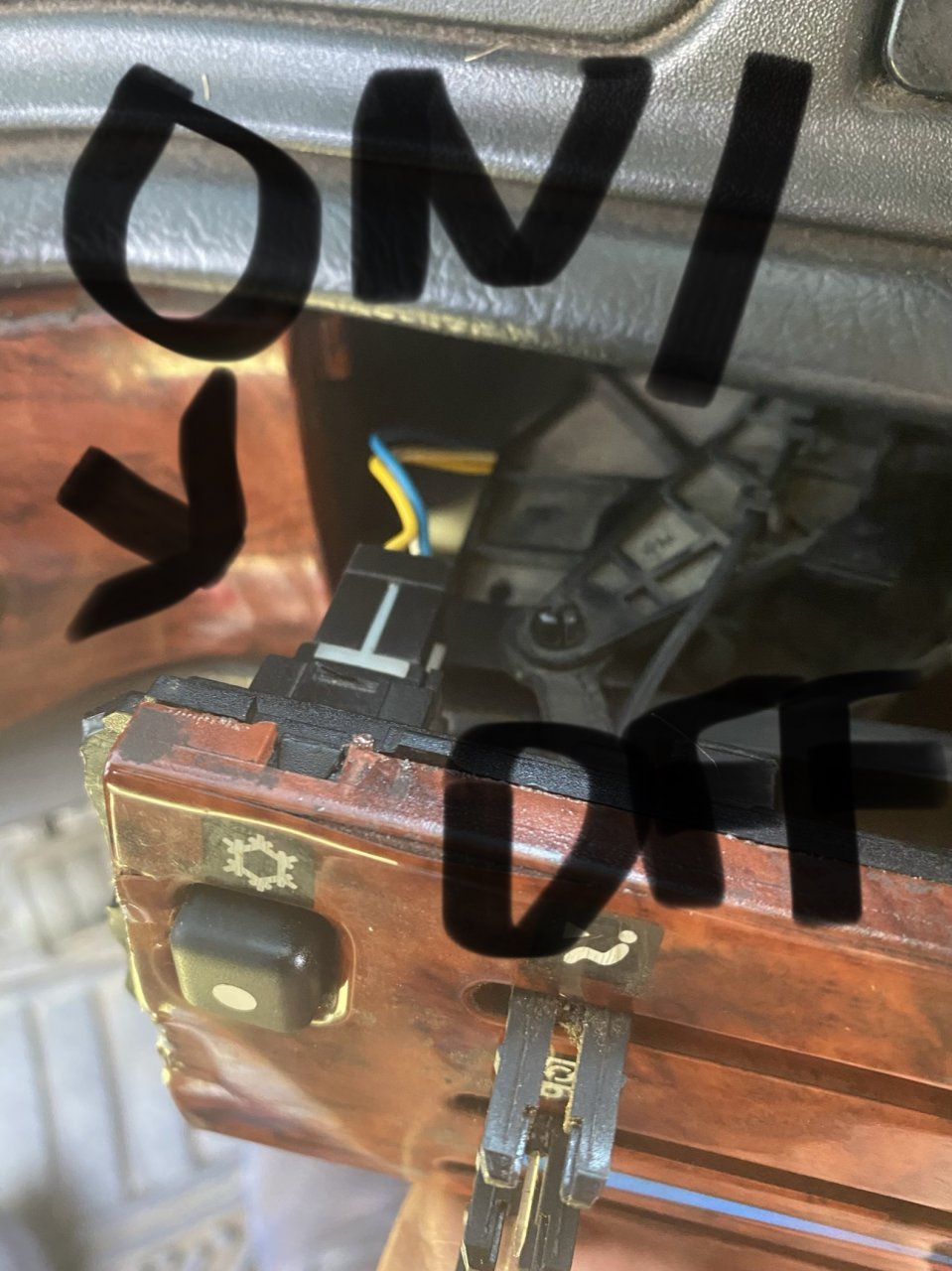

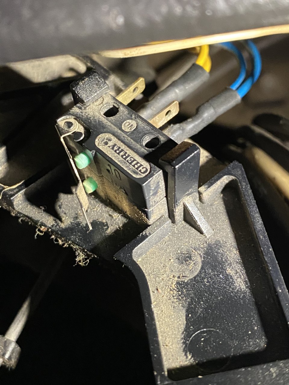

    I have a new a/c on off switch. When I press it, the relay will click. Can a relay still be bad if it clicks? I’ve replaced the relay with a spare used one I have, still no juice to the compressor. The fuse is good, and so is every other fuse I got in the box.
    I wanted to ask, am I missing something? Tomorrow I’ll go buy a fresh relay to see if that’s it. From the relay, I don’t know where else it would go besides straight to the engine harness / compressor itself? There is what seems to be a blend door involved too. I should of tested it for power. I did replace the blower motor resistor too, because I guessed wrong on the first diagnosis of the blower motor. Any ideas? Thanks!

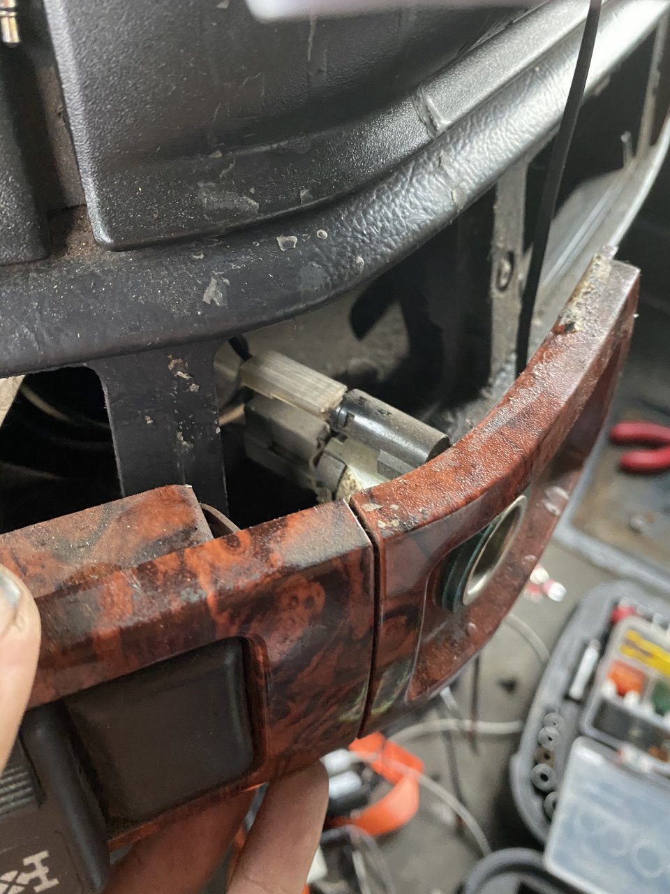

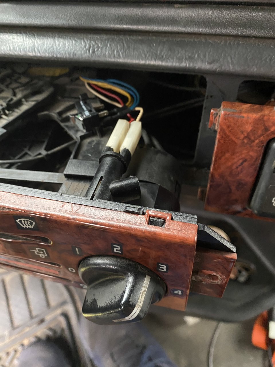

    Idk, do either one of these two look like the temp sensor you remember? One on top of the 12v cig lighter, and the other is built into the a/c module piece. E29E45E3-32FD-428C-A1BE-231807F04999.jpeg 1F6A7CF9-E76E-4E47-A248-F49E26789A90.jpeg

    It's to the right of ash tray opening behind a little grill

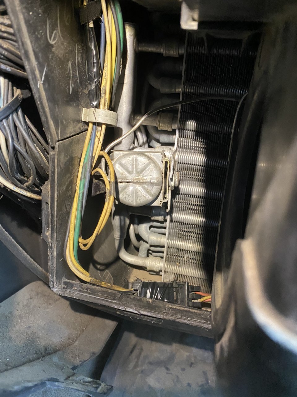

    Could this be the valve? Or is that more like a temp sensor? I see the metal line going into the condenser, maybe to read temp? It’s got two electric leads to it.
